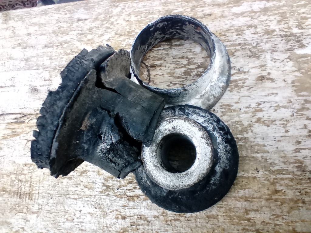

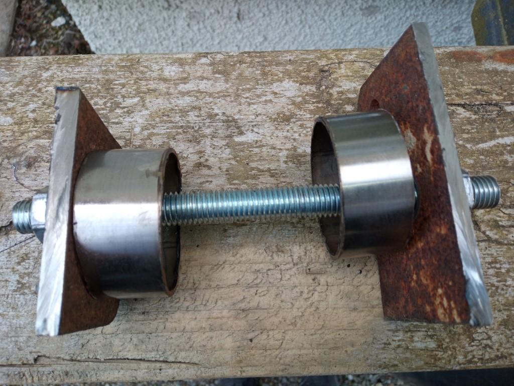

The good news is that I've managed to replace both pairs of lower rear bushes using home made tools. The official Audi tool costs $370 from the US. Mine was made from some 12mm threaded bar, a piece of stainless steel pipe obtained from a scrap yard and part of a scaffolding base plate, cut to size with a cheap battery operated angle grinder, with the bushes being put in with the aid of an impact gun.
This photo is the worst of the four bushes, the next being not much better. There was no effort required to removed the central section or the rubber bush itself. The drivers side wasn't as bad, but they say to replace them on both sides.

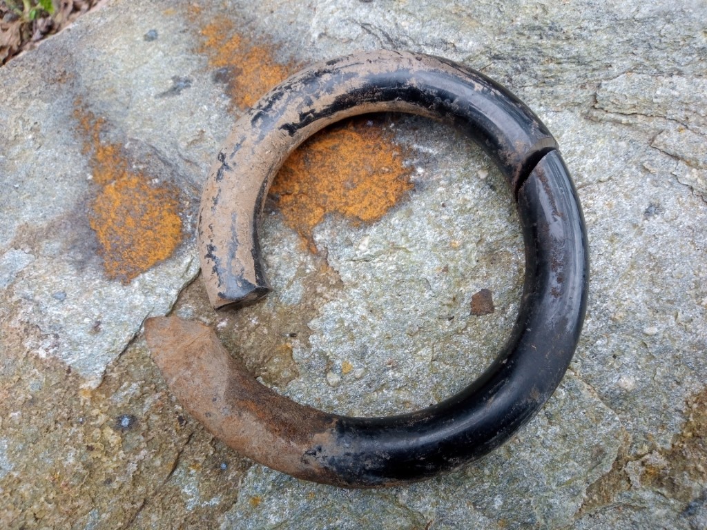

Now the more bad news. Was replacing both precat O2 sensors as codes for them popped up recently, and while I was underneath spotted something. The passenger side spring is broken near the bottom, so they need replaced as well before MOT, and I think that job is well beyond my skills... and tools.

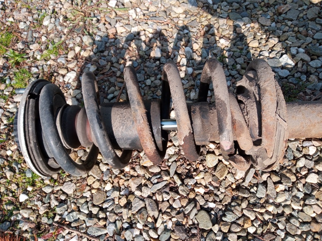

Anyway, this is how much of the spring that broke off (cut again with an angle grinder to get it out of the way):

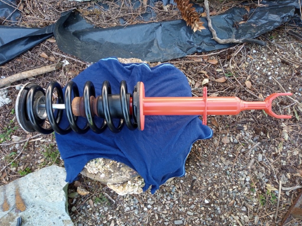

This is the before and after solution, and yes, those are genuine old 'new' stock shock absorbers. Bought them in 2017, and even back then had difficulties getting them shipped across to NI. Ended up sending them to my brother who was still living in England at the time, and he brought them over when he came fishing.

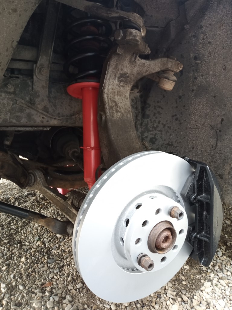

And this is the final result, times 2:
