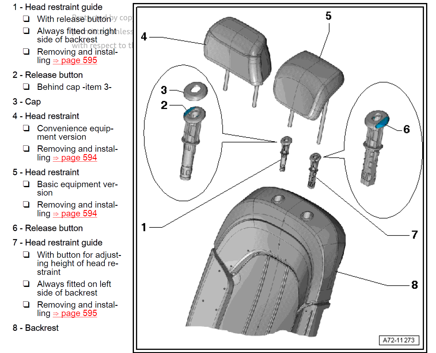

Welcome to the club.
As for removing the rear headrests, check out the attached image. The release buttons (2 & 6) are hidden beneath the plastic cap (3). Prise #3 up and go from there.
