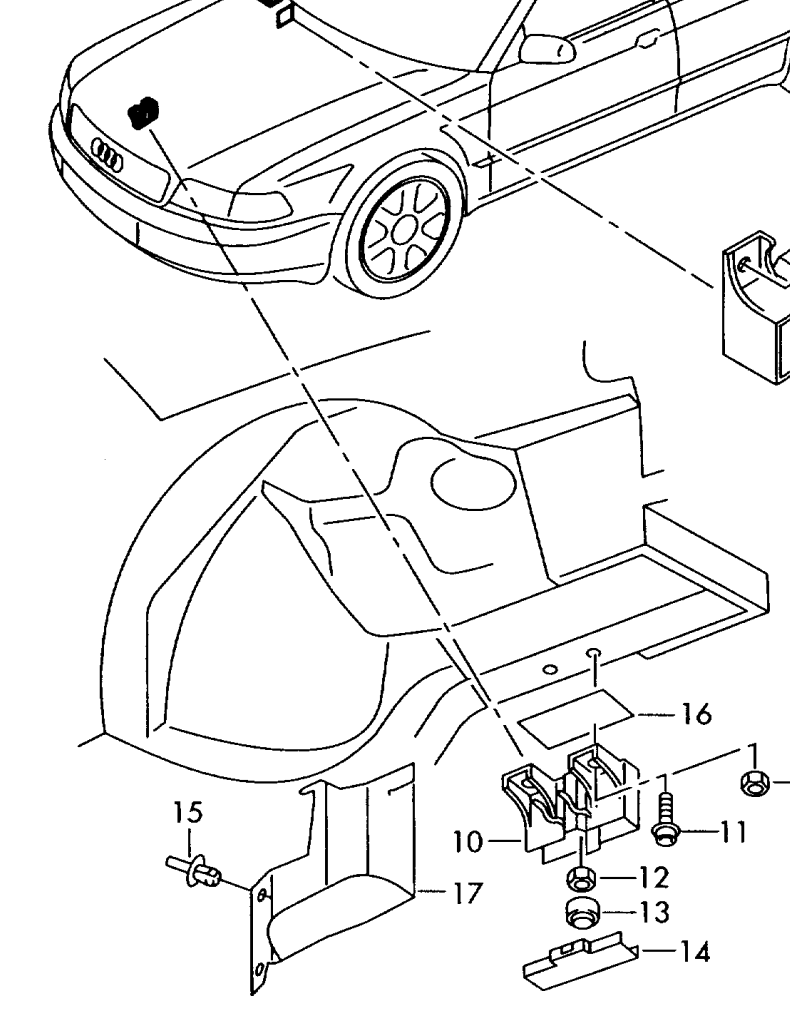

Originally Posted by Simon Wallwork View Post
Are there any obvious places to start looking for the problem?
Two possible culprits worth investigating:
1. The battery connection block underneath the drivers side chassis leg. It should have a black cover on it. Remove it and check for corrosion. There are photos of it on the forum, but here's an illustration on what you're looking for (item #10).
2. The voltage regulator on the alternator may be failing/failed.
Name:	Screenshot 2024-11-15 093202.png
