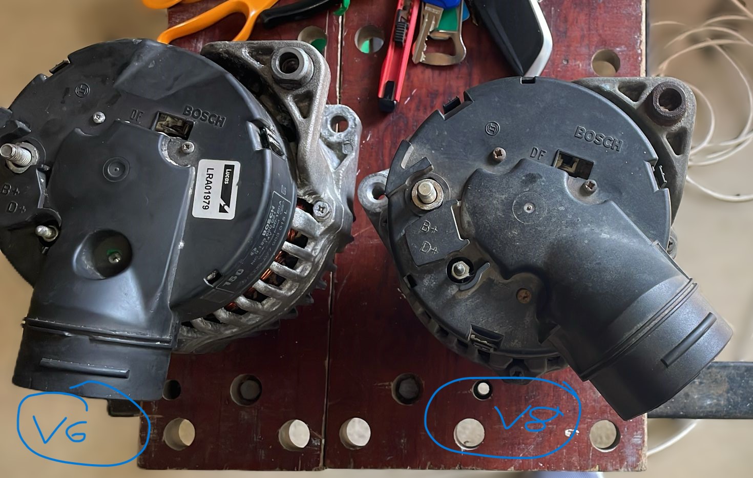

Be careful not to buy the V6 version
Changed mine last year, bought a refurbed unit from D2 Doctor
077903015P is the V8 part, I think, K might also be compatible
