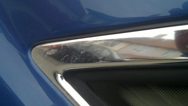

now it seams the problem is all the chrome trims are covered in lacquer and moisture buildup between the lacquer and chrome causes a milky effect as shown hear on mine in the first photo.

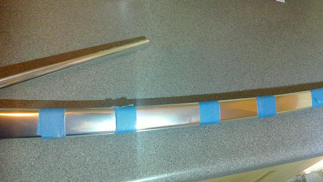

Today i recieved a chrome trim from a8part that had the slight milky effect on it. this i decided to have a go at sorting it out. its better to sort out a second hand one than trying a load of different ways on the ones on my car just in case something goes wrong. anyway i put some masking tape on different sections and dug out some polish.
the first section i used autoglym metal polish and applied by hand. after some time with a lot of elbow grease it started to come clean. on the second section i used some cutting compound and finishing compound applied by hand, again similar results. third section i used same compounds with a dual action polisher. that idea just caused deep scratches. the fourth section i used meguiars nxt generation all metal polysh. now this seamed to come up pretty good. tha last section i used auto glym fast glass and this did nothing at all.

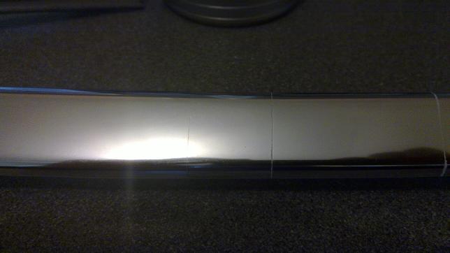

as you can see from this photo with the tape removed there is still the milky effect under where the tape has been.

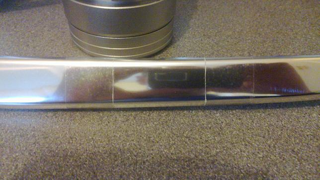

this is the same trim with the section shown using the nxt metal polysh.
