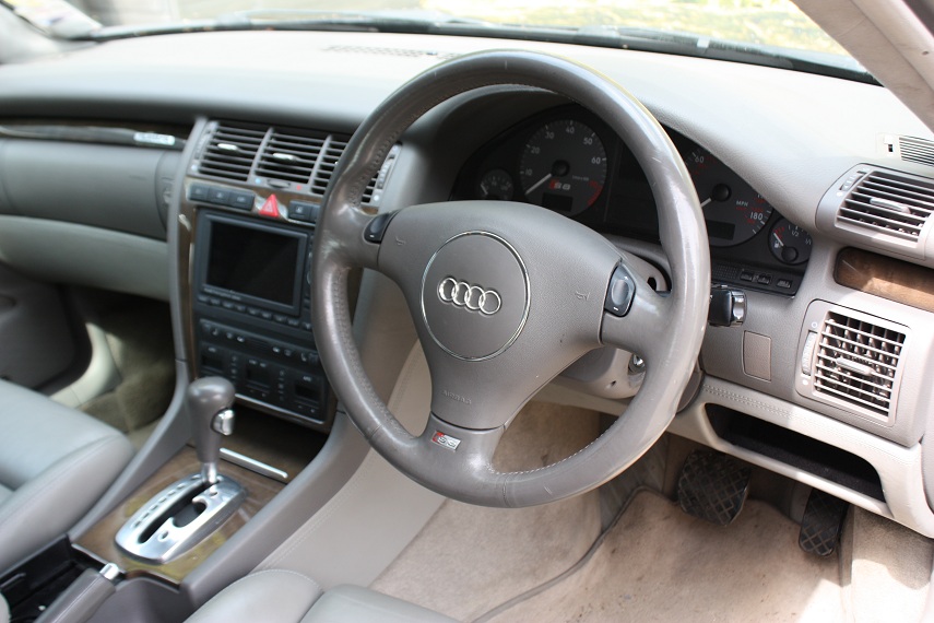

Heres the original factory fitted wheel:

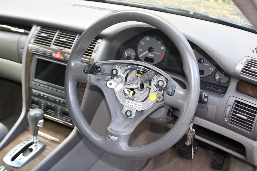

So firstly we need to remove the airbag. For this you probably ought to disconnect the battery etc and use extreme caution when handling the airbag but I tend to just do it with ignition off to be honest, but dont come crying to me if your airbag goes off
There are two T30 Torx bolts on the rear of the steering wheel out of sight. You will need to turn the steering wheel off center to be able to get a socket into them. They will be tight, but will come out.
Once they are loose, the airbag is loose. It will have a connector into the center which needs disconnecting carefully.

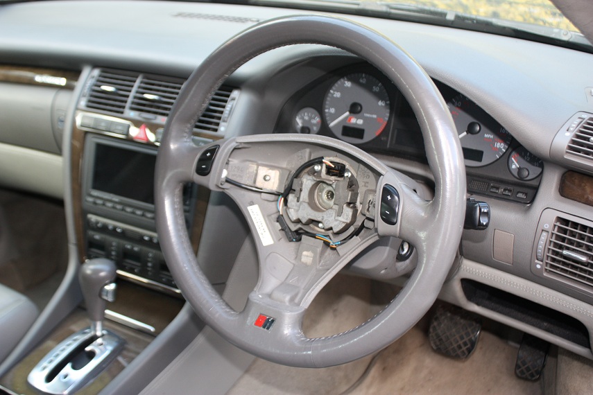

Before the wheel can come off, you will need to disconnect the black connector shown a the top of the steering wheel from the slip ring behind it. This connector has 4 wires - ground, tip up, tip down and illumination. The connector below is for the airbag and horn.

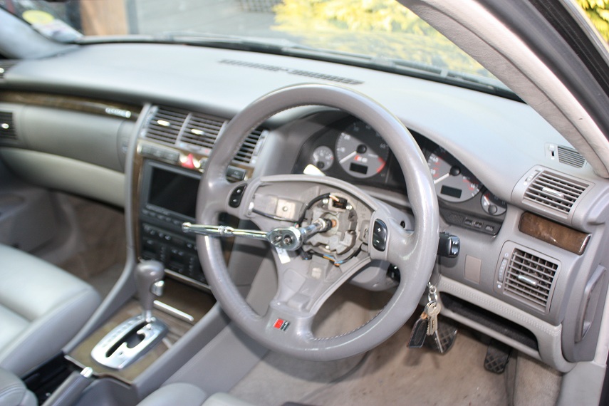

The center bolt is a triple square of some size I believe, but I'm so vague because I always use a Torx T55 which is a perfect fit. Use a small extention to get you clear of the wheel itself.
This bolt will be dam tight. I wouldnt advise having the steering lock on as you run the risk of breaking it with the force needed to relax this bolt. Instead leave the steering loose and use the cars natural instinct to not want to turn the front wheels to wrench against.
I strongly recommend centralising the steering wheel prior to removing it to make it a heck of a lot easier to get the new one on straight !!

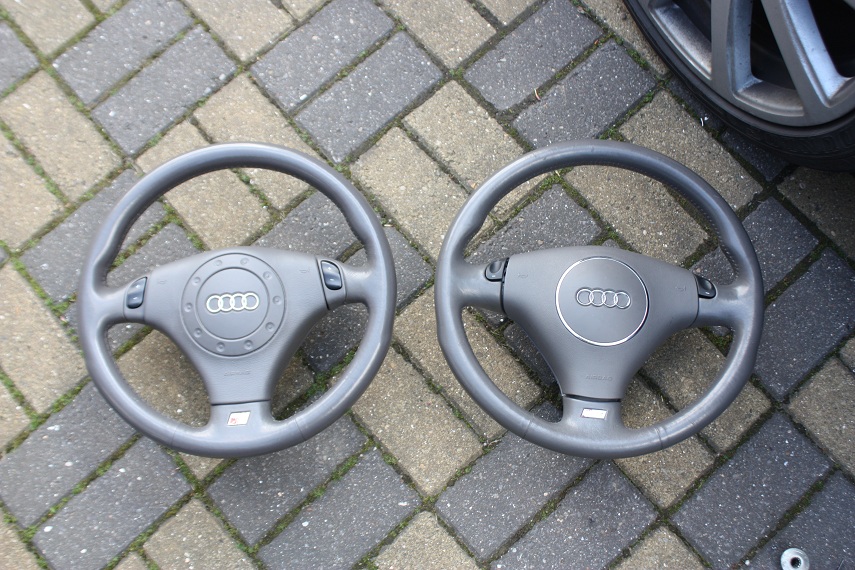

Here are the two wheels side by side - Old on left, new on right. Note that getting the right colour is important as the steering wheel is designed to match the upper dash colour, so could be beige, grey, black, brown (Rare) or a few others.
Its interesting to note the new wheel is about half the weight of the old one...

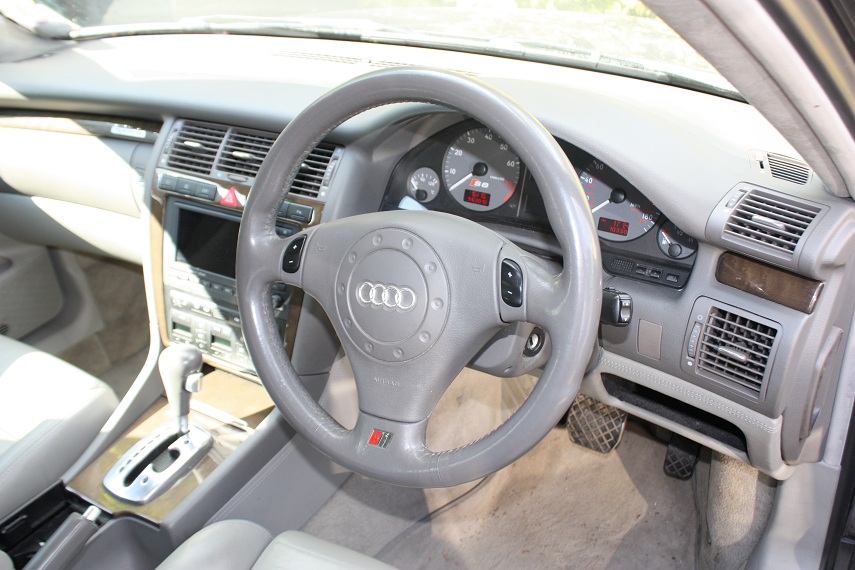

New wheel in place, ready for bolting back up:
and airbag back in, screwed up using the same Torx 30's behind
