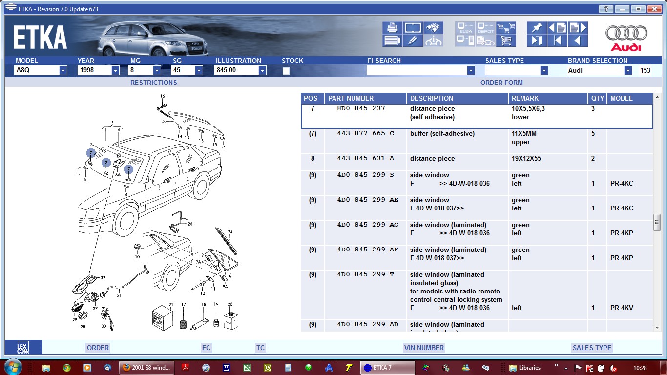

Part numbers required:
b 357 845 955 Cutting wire for removing windows
b DA 004 600 A2 2k-window adhesive set
b D 009 200 02 primer for glass and paint
b D 009 401 04 cleaning solution
b D 000 703 A1 One set glass metal adhesive
The foam is
8D0 845 237 distance piece (self adhesive) 10x5, 5x6,3 lower (3 of)
443 877 665 C Buffer (self adhesive) 11x5 mm upper
Nothing stopping you doing it now Glynn!
Old 20th September 2010, 09:51 AM
GlynH GlynH is offline
Location: Oxfordshire
Posts: 239
Jesus wept...no wonder they call you 'Conan_the_Librariann'
<deliberate typo as you got my name wrong as well>
Can I be cheeky and ask what windscreens were available for my car please?
The reason I ask is National Windscreens tell me the heated screen was never an option in the S8...I am told mine will be green on grey/no mirror boss or something like that...

Old 20th September 2010, 12:20 PM
Posts: 3,877
-=Glyn=-, Ok (now I will get you mixed up with =-Glyn-=)
Heated front windscreen is:
4D0 845 099 CS
There a 6 different front screens only one heated.
The sealing strip is actually 4D0 863 197 A (25x11) or C (15x15)

Conan_the_Librarian: OK Mike...thanks for all the info as always!
I am almost afraid to ask as I saw what you done to those guys in the library... but exactly what bits of foam do I need to supply to National Windscreens for them to make a proper job of replacing my windscreen? One of each listed but 3 x 8D0 845 237? 10x5 or 5x6?
4D0 863 197 C (15x15)
I guess they will have the wire/primer/solution/adhesive or would I just be better off supplying everything apart from the damn screen?
