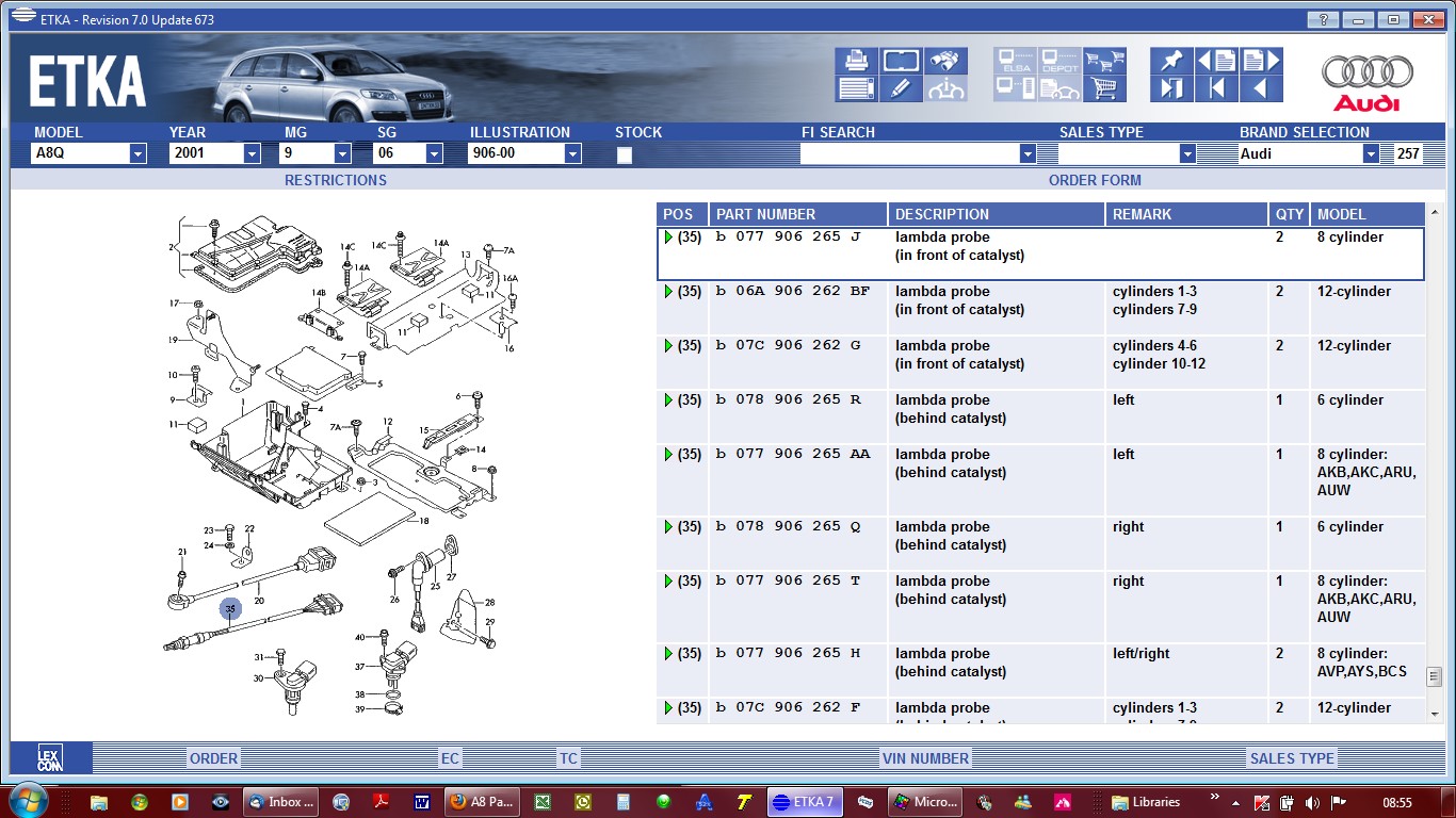

Old 14th October 2010, 03:19 PM
Posts: 3,876
Front = b 007906265 x 2
Rear = b 0777906265H x 2
Old 14th October 2010, 09:49 PM
GlynH GlynH is offline
Location: Oxfordshire
Posts: 239
Sorry Mike...I must have missed this one...
Not wishing to draw your meticuluous library records into disrepute but I have been doing some looking myself...looks like there might be a typo above or my own research could be wrong?
Probe 077906265J
Probe 077906265H
It would appear that the H is nearly a tenner cheaper than the J for some reason?
I am guessing when you refer to front this is pre-cat (before) and rear is post-cat (after)?
I might submit my list so far to a dealer and ask them to check part numbers are correct and see if they might offer a discount on a job lot?
Thanks & kind regards,
-=Glyn=-
Old 15th October 2010, 07:56 AM
Posts: 3,876
sorry Glyn!
Fronts are 077906265J

Old 15th October 2010, 10:46 PM
Posts: 239
For Gods sake Mike...there is really no need to apologise!
As always a mine of information...much appreciated.

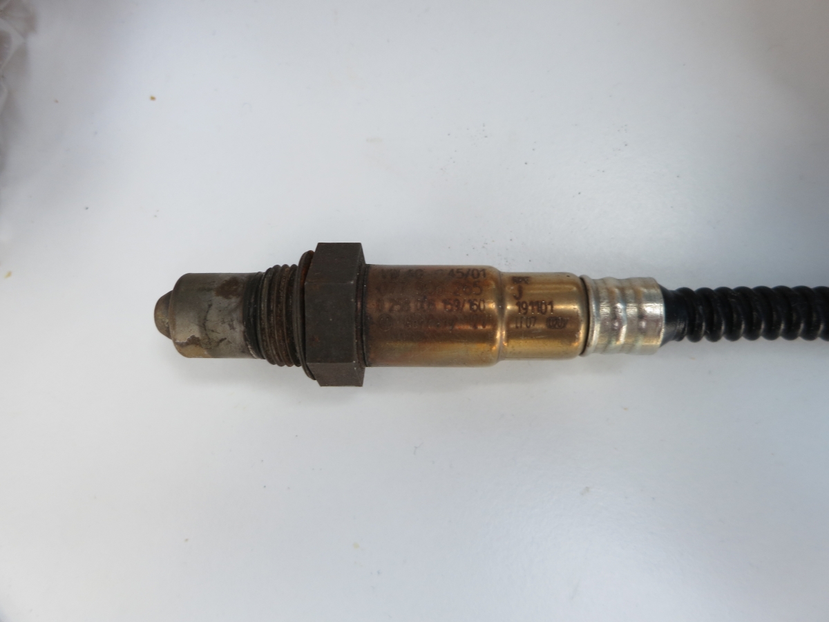

Old 14th March 2015, 08:45 AM
I think you should be ok, its manufactured by Bosch so should be identical?
Here is a picture of my old front lambda that came out of my previous facelift S8, this is the Audi original one, as you can see (sorry a bit blurry) it has the same Bosch number plus Audi stamp their own number on it.
Here is a cheap one on Amazon.
http://www.amazon.co.uk/Bosch-025800.../dp/B0068MXWRW

Old 14th March 2015, 10:30 AM
Cornershop Cornershop is offline
Join Date: Feb 2015
Posts: 254
Thanks Goran, I had that bookmarked. Glad to hear there are cheaper sources.
Apparently both my pre cat sensors are stuck solid and will need the down pipe to be dropped as well as the Kombi valve removed
Not a cheap piece of work all in all
