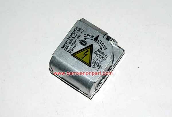

Will do thanks, it flickers like it's about to light up then doesn't now so could it be the ignitor? On the plus side I've been running the car on V Power as too lazy to go to the LPG filling station and it drives like a dream. Wish I'd run it on petrol more often. Could someone tell me where the ignitor is and where to find it?
Old 12th February 2011, 08:57 PM
should look like this Amar from memory it is normally inside the housing

Thanks Neil, I popped into Revo yesterday, I couldn't even work out how to get the bulb out. The Xenon plus design on this is different to the ones on my S8. The ballasts aren't mounted to the headlight for starters. Ben had the bulb out in seconds and said it's blown so I will swap them over to see if that's defiantly the case then get another on order otherwise its going to start getting expensive.
