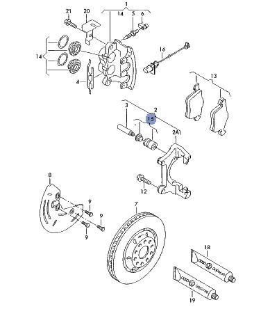

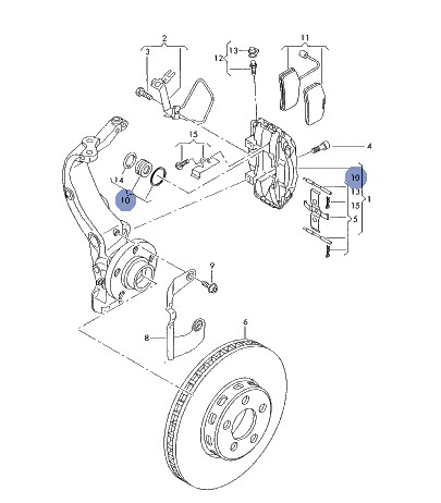

If you have Brembos then there are no shims. Are these your brakes?
They may well be Teves, in which case all parts are replaceable.
