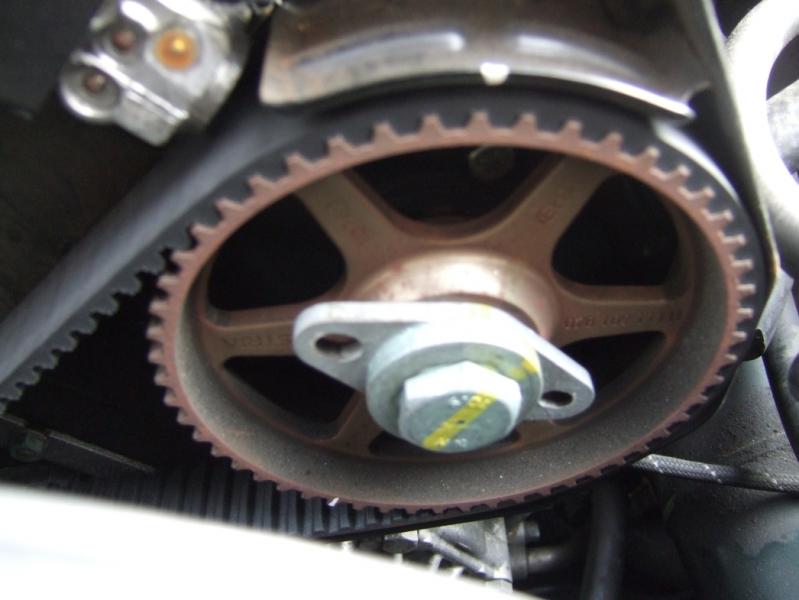

To cut a long story short, I concluded its either the cam chain tensioner, or the timing belt was put on wrong. So yesterday I opened up the timing belt covers and guess what, I saw those tell-tale tip ex marks Ben warned us about.

Could it be that local mechanic put the timing belt on without the cam clamp or crank bolt?
Also further proof they didnt use the clamp is that when the big holes on the cam sprockets are on the inside, as per Elsa, the tip ex marks are on the bottom of the sprocket. Unless it was the Audi dealer that put on the tippex when he did the belt for the firs time 4 years ago? Do they normally change the sprockets for new ones?

Tip ex marks a sure sign of someone doing half a job!!
Ticking could be due to loose belt or a cover touching somewhere. Needs checking matey

Tip ex marks does not necessarily mean that it was not done properly with the locking tools. Many places choose to put a marks on before taking cambelt off to have a reference point especially if heads or camshafts come off. But since they don't align up with the big holes in position they most likely did not have locking tools
My point is that the cam pulleys are removed and spin freely relative to the lockled cam shafts themselves when fitting the belt so if you were to put a mark on they would not mean anything so are completely uselss.
trust me, if there's tip ex marks on the cam pulleys, it was done wrong!
