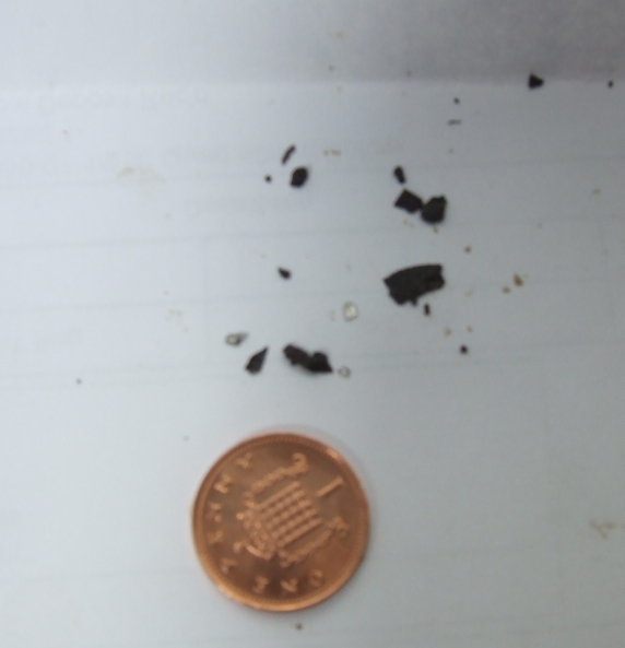

Is it normal to have a bit of swarf come out during an oil change for a 100k mile car?
I did a 3rd oil change by myself, after 8months and 4000 miles, and this time round I decided to sieve the oil as it came out with a fine sieve - except I forgot to do the same when emptying the filter housing. So I dont know if the bits are from this oil change or previous - sieve didnt catch anything I found them in the oil pan when I was panning for gold
The black bits are crunchy and fragile.
Any shared experiences much appreciated.
Name:	Oil Change April 11 bits.jpg

That's called tea leafing and is caused by using low quality oil and cheap petrol. give it a forte oil flush and only use quantum synta 5W30 and VPower or BP Ultimate.</p>

Thanks Conan, its reassuring that its normal. I always use Quantum / Castrol Edge 5w30 and V-power, except about two years ago in Europe I had to use some French fuel in an emergency, maybe that was the cause.
There where also 3 tiny aluminium bits, nothing to worry about?

Castrol Edge is not a good choice. while it meets the VAG standard it is not as good as Quantum. it's also dearer. the aluminium is a tad more of a worry. if it where me I would whip of the sump and check the oil pump filter. flush and change my oil.

sorry! looks like false alarm on the aluminium bits.
I forgot to mention I also had to replace the oil filter drain plug because I chewed it up last time because I didnt push the hex all the way in and because its a helfrauds hex so the fit was a bit loose.
So this time I chewed it up some more getting it out, and that was all taking place above the oil pan. I test fitted a couple of the bits back into the gouges of the plug under a magnifying glass and they seem to fit.
