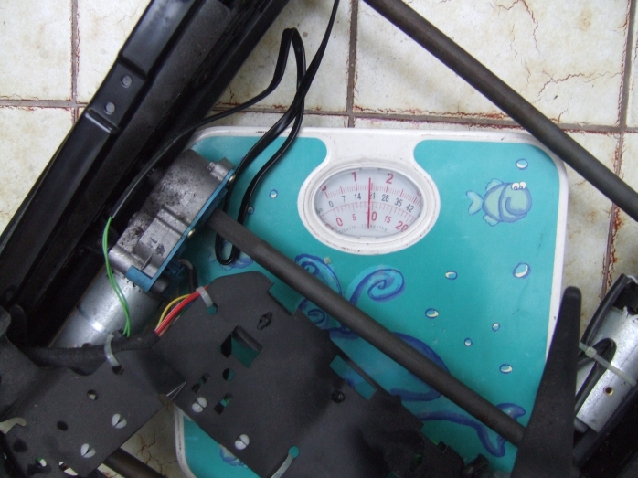

Old 11th September 2011, 08:06 PM
Finally got round to dismantling the base of the recaro seat. The base containing all the forward/backward up/down motors weighs around 9kg.
One option may be to replace it with a manual adjust base, although I suspect this may only save around 4-5kg of weight (if it even fits).
Another idea I had was to find out if the recaro foam cushions and leather will fit onto a completely manual seat frame.
A third option could be to go for Audi TT manual recaros, on the web it says they weigh 22kg each, thats a saving of 28kg for 2 seats and they look close to stock.
The next task is finding out how much the adjustable lumbar support weighs. Dont hold your breath I'm a slow worker
