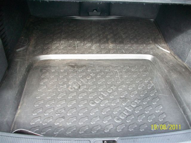

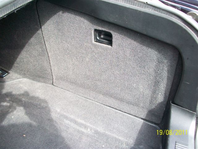

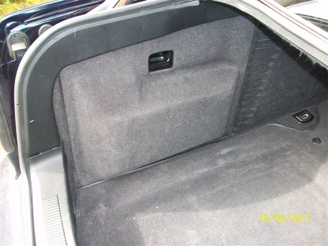

Here are some piccies of my boot space (it's stopped raining!).
Let me know if you want any additional photos of anything specific

Thanx Mate..... Much appreciated.
Perfect...that's all I need.

Did you find out what's missing from the rear left corner (yours and mine)?
Old 19th August 2011, 01:51 PM
Theres nothing missing, well not on UK spec anyway, I've never seen anything fitted into that hole...
