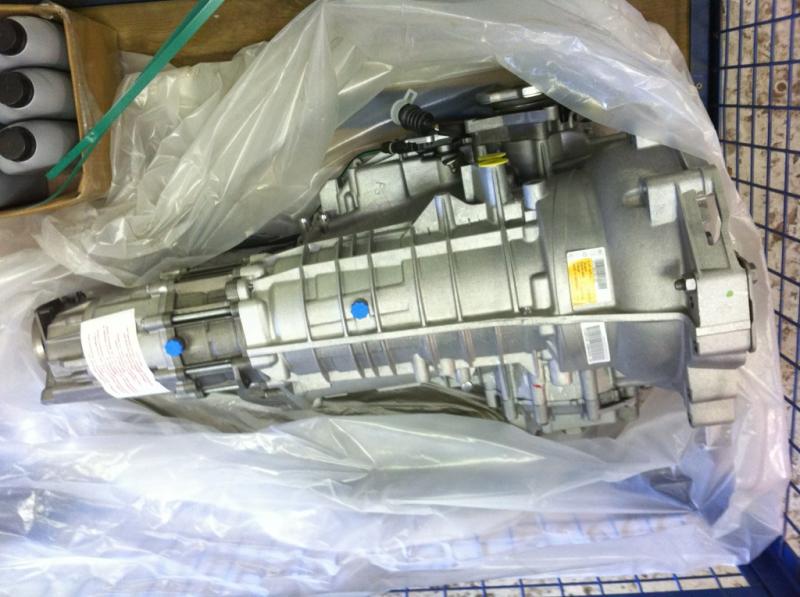

I bit the bullet when mine went and got a VAG service exchange box with 2 years unlimited mileage warranty. for that you get a new gearbox, torque converter, TCU and even the oil already in it. The cost was a not inconsiderable £2400 for the exchange but when you consider a refurb doesnt give you new everything then its worth thinking about. . .

thats what I said I had above - it was £2400 at the discounted trade price from TPS and came in a service exchange VAG crate

That's about the going rate for boxes from Audi - mate said RS6 boxes are about the same. Defo the best option, if you can justify spending the money as you'll have warranty and a known quantity going forward. Worth then doing a gearbox oil change every few years/tens of k miles to keep it running sweet.
