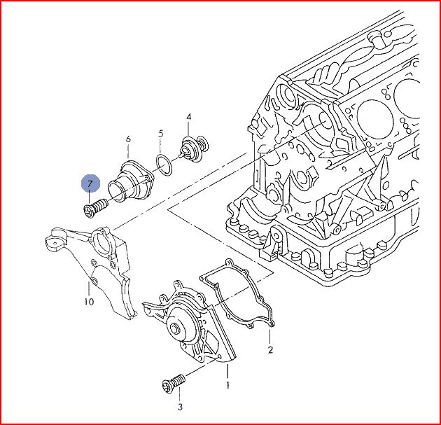

Went to change the thermostat today but theres no way i can get the bolts out, i have already twisted one torx bit and started rounding off the inside of the head with another. The only way i can see to get these out now is with a cold chisel or i take the front end off to get an impact driver in there.

Could i have the part numbers for the 2 off bolts for the thermo housing please as they'll be no good if / when i get them out.
Bump for the part no for these bolts please
Old 1st March 2012, 06:42 AM
Architex_mA8tey Architex_mA8tey is online now
N 905 375 02
Hexagon socket oval head bolt (combi) M6X20 2 off @ £0.47 each
