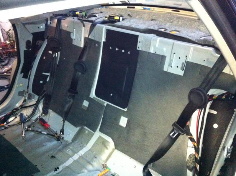

This will reveal the actual plate where the ski hatch goes, which is marked. Simply cut out the plate, and all should be straight forward.

. . . And this is what it looks like out
Name:	A8 Rear Seat Out.jpg
