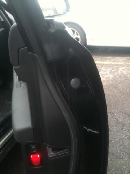

audi a8 d3 drivers side door handle is loose , how do i get to look at it, i have taken off drivers door card and there is an aluminium plate after that, which i can't take off any ideas. thanks

There is a rubber plugged 'hole' in the door frame which lets you use a Torx to unscrew the handle and lift it out.
So when you open the door and look at the latch there should be a cover
