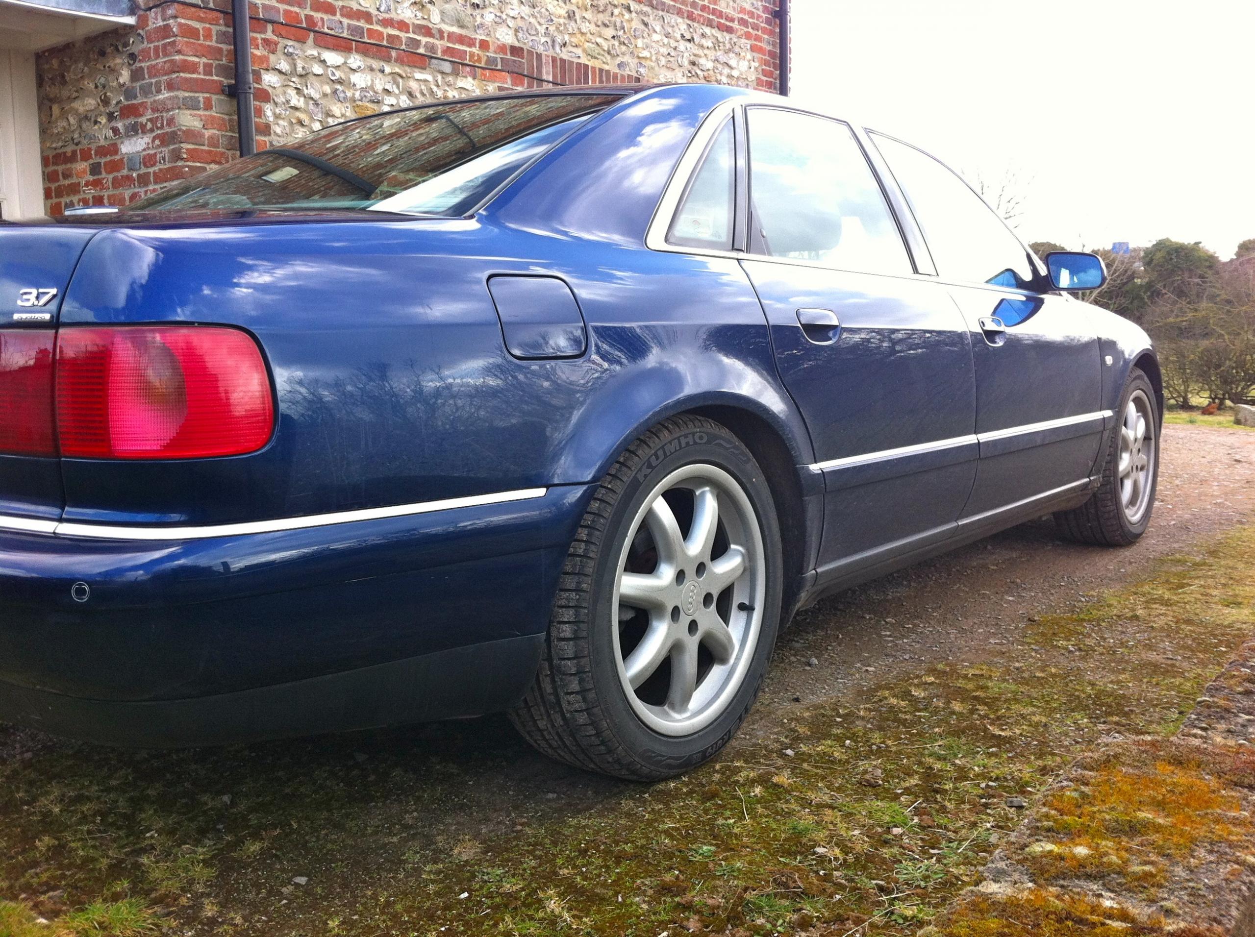

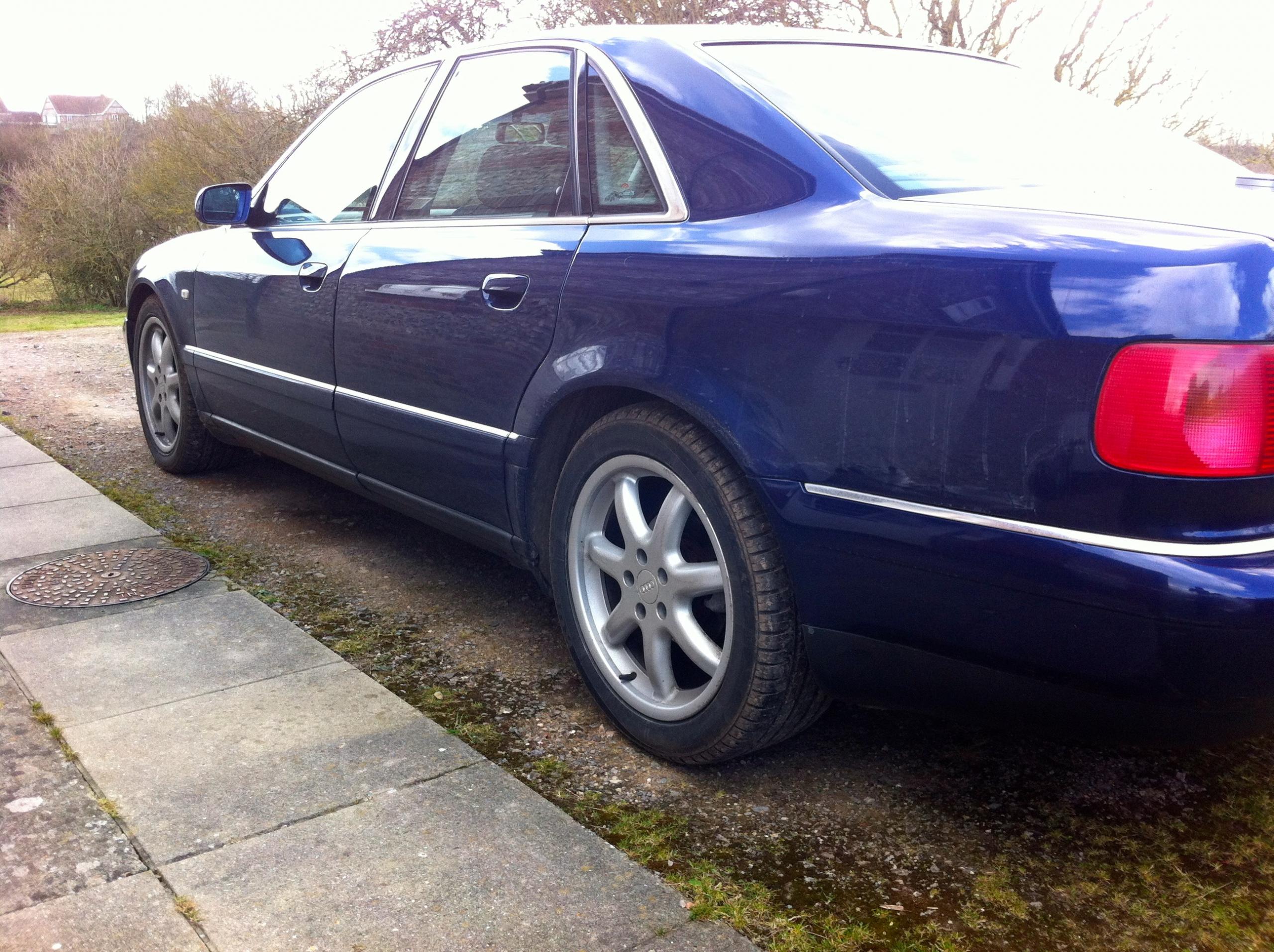

can you take pictures of both to compare? would be good to see how different they are.

Here are a couple of pictures showing both sides, sorry the quality is not great.

Old 3rd March 2012, 12:24 PM
Could be a weak spring or even a broken spring then, worth getting underneath for further investigation
