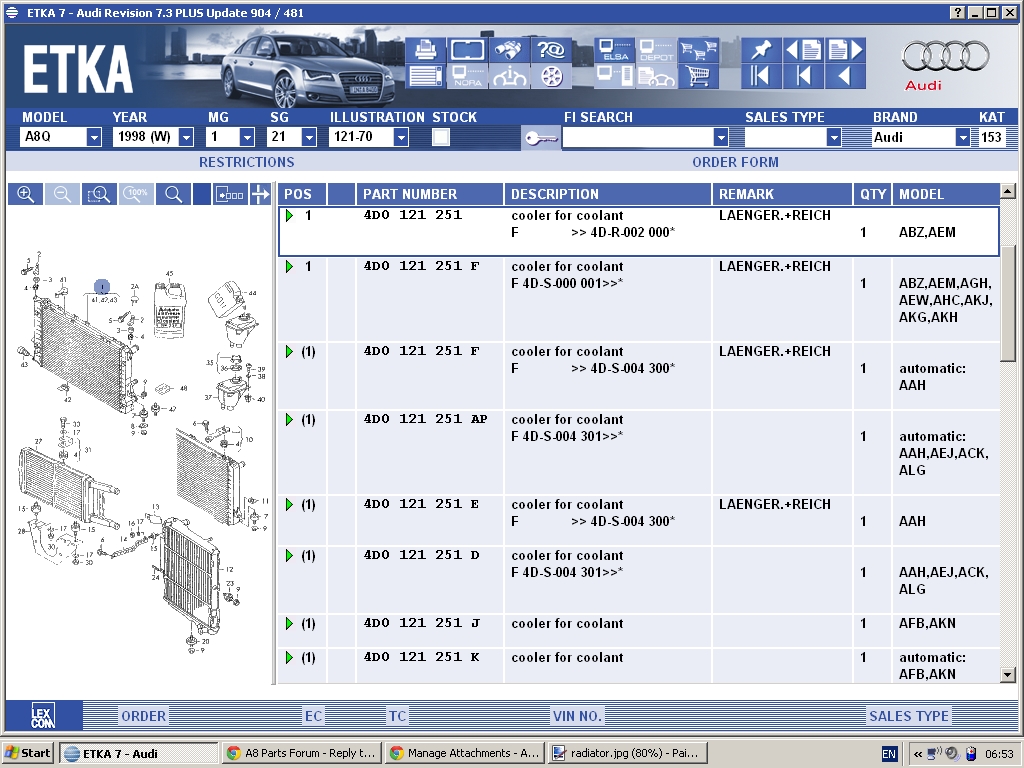

Car details like year would help anyway here are available options for 1998 A8Q

V6 and V8 Radiators are different - the bottom hose connects by bayonet fitting for the V6 whereas the V8 uses jubilee clips and also the hose connections are in different places. The V6 also has a different radiator housing as the Viscous fan and Electric fan are the other way around on the V8.
