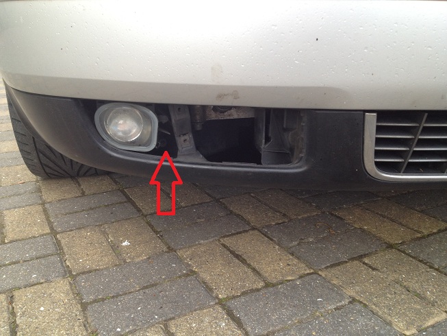

I dont use my front fog lights. Its rarely foggy enough to bother with the back ones to be honest, but the problem is that if the front ones have a broken bracket, then its impossible to keep the front grills in place, which, cosmetically speaking is a really big problem, and an expesive one.
Here is the offending foglight. It is held on with 2 torxs screws on one side, and then its clipped in the left hand side. The problem is that with it broken on the right hand side (Arrowed) there is no real support to keep it there. No support = vibration = bye bye grills.

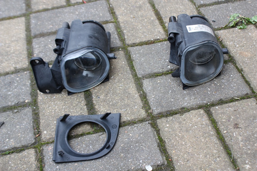

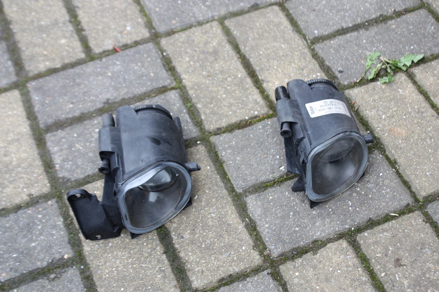

Here is the good replacement fog light, alongside the broken one:
And here, with the 3-pronged fog light grill, which covers the fog light, but only if the fog light isnt bouncing around everywhere !
So, swap the fog lights, pop the grills back in and hey presto
