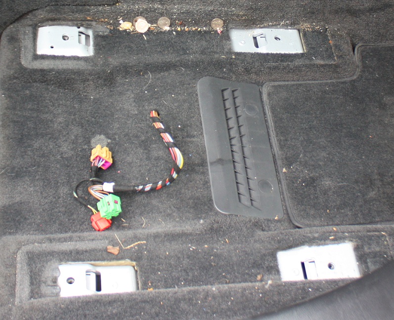

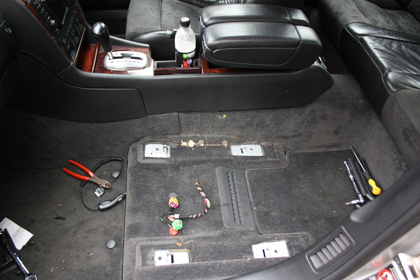

A quick one, here ,but to anyone thats never removed a D2 seat, there is probably an air of mystery.
All D2 seats, front at least, have the same electrical connections and bolt holes. Facelift are all identical, but prefacelift sees quite a few changes over the years, airbags, rear footwell lights etc.
This is the passenger side, absent of any seats, showing the position of the cables, and bolts holes
So, the seats are a nice easy, 4 bolts, 2 parallel rails install. Electrically, the brown connector takes all the power, lights, seatbelt adjustment connections - The green one takes the heated seat features, the 2 pin red one is for the airbag ignitor.
Note also, its rare not to find money lost down the side of the seat. In this rare occasion, even the passenger has loose pockets. Cool
