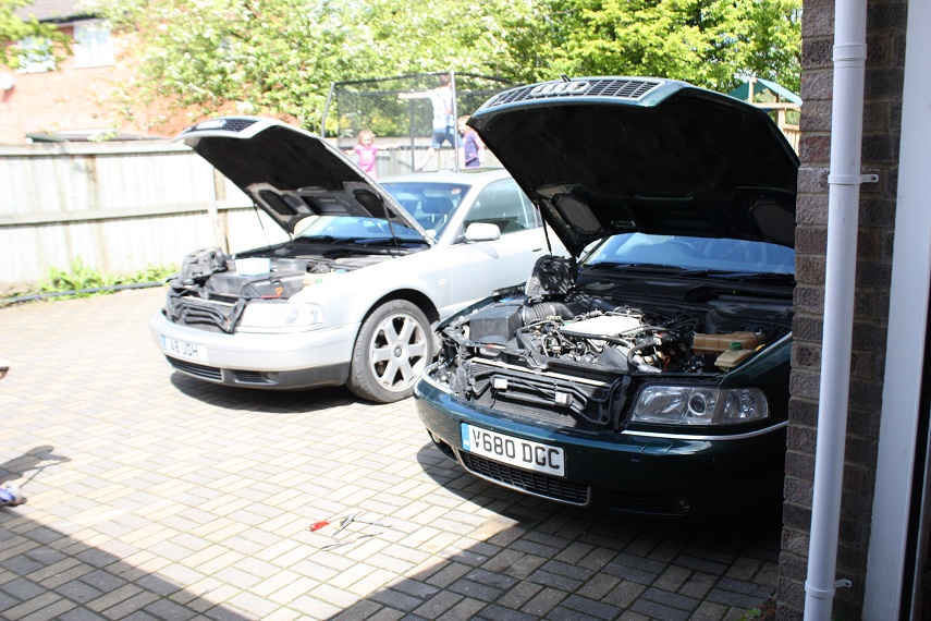

So, I needed to change over the bottom-most pump which was ok, as I have a donor car. The easiest way to access them is to remove the drivers side headlight:

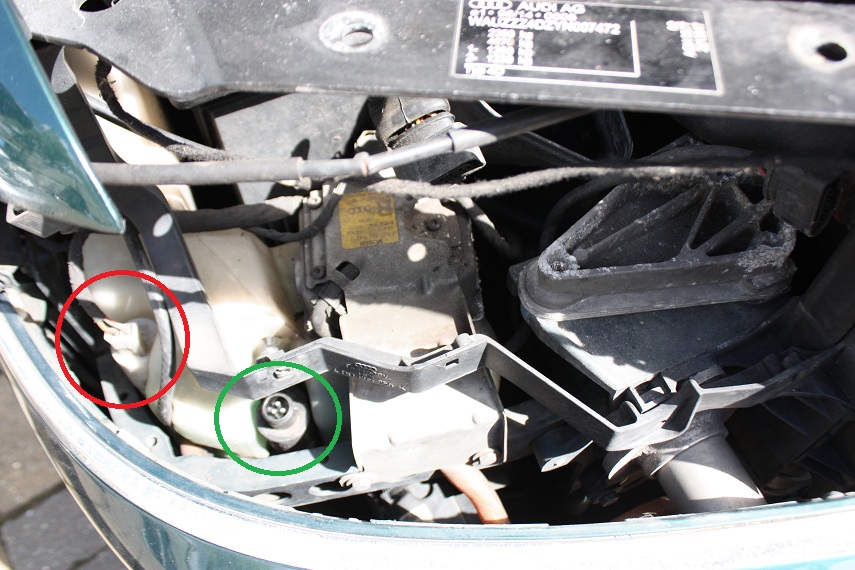

Once removed, you can see the pumps, and work them out with a bit of jiggling.
The bottom one is circled in green, the top one in red.

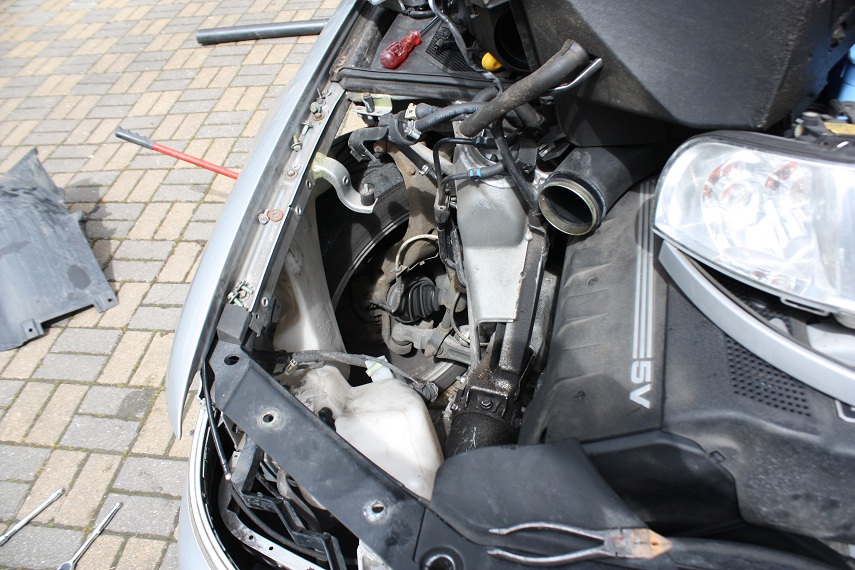

Getting them out was ok, but when I put the pump back in, it pushed the rubber sealing grommet through into the tank. This meant I had to remove the whole tank to get it back again.... Aarrgh. !!
So, airbox out, wheel arch liner out, a bit more wiggling and out it came. I retreived my grommet, put the pump back in *carefully*, reassmebled the whole lot and hey presto, warning light gone..
