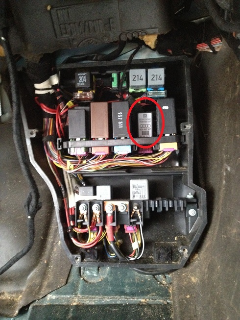

My A8 had a fault with its powersteering. It was heavy. I'd not really thought much about it, but it was heavy. I guess it could be the pump or rack, both of which are a bit of a messy mess to start fixing. Not my cup of tea, but it was on the list so off we go.
My first inclination was to assess whether we had any power assistance or not. This car has servotronic, so its speed dependendant. It adds another level of complication to the troubleshooting, but it rarely the cause.
I noted that the steering was heavy at standstill with the engine running, but nothing like as heavy as at standstill with the engine off - so concluded we have power assistance, and as there were no drips, that the hydraulics were probably ok.

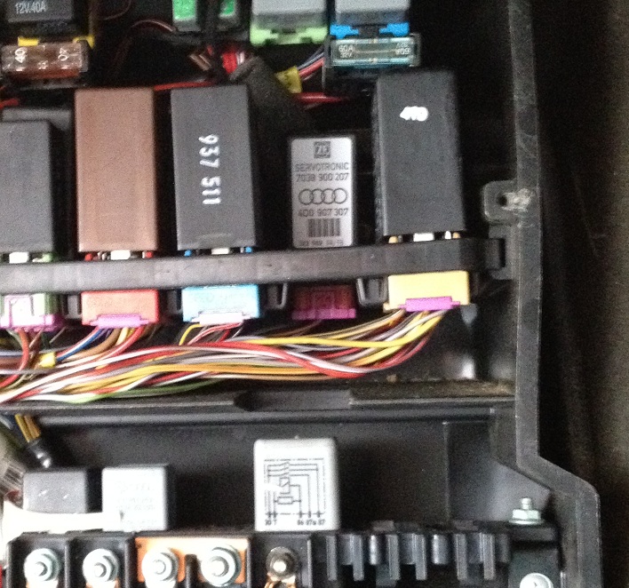

There is a servotronic relay in passenger footwell which takes speed feeds etc from the car, and converts it into power assistance. This was where I was going to need to get good with the test meter to see whats happening, or not.
The s8 donor car I have at the moment on the drive also has servotronic, so decided for the 30 seconds it would take, to swap over the servotronic control modules to see what happens.
It only went and fixed it.
Works perfectly now. What an easy fix... Over the moon
Heres some photos of the offending module in situ:
