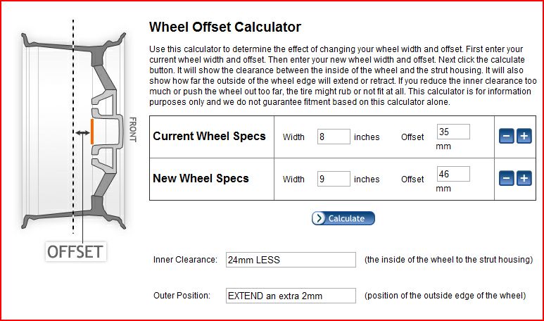

The offset effect depends on what the Avus wheels offset is?
You can use the calculator HERE to double check the effect for your car specifically - example below

So are you saying the above is correct then. My Avus alloys are 8" and I think the offset is 48 (correct me if I'm wrong), and if I put on a 9" wheel with a 46 offset I will need a 15mm spacer ? Will the car drive ok by not having the same offset ? Will it put extra load on wheel bearing etc ?

2mm differencein offset is not much and effect on bearing will be minimal. I don't think you will need spacers or at least not 15mm maybe 5-10mm because wheel is wider. Using spacers does put extra load on bearings. You need 11mm extra space on inside, check the clearance with old wheels and if you have more then 11mm clearance you will be ok.
Old 20th June 2012, 06:22 AM
^^^ Wot he said" ^^^
it looks like the extra inch width of the wheels is spread over 11mm on the inside of the wheel and 15mm on the outside so take a look at existing clearance both sides and see what you've got. If the inner edge is close to fouling the suspension arms etc then you may consider using a hub-centric set of spacers - probably 10 or 15mm to move the wheel further out.
It sounds like you will have space but at the end of the day it is something you will have to take responsibility for checking and the final decision but plenty of folk have 9" wheels successfully installed on the front of their D2's. The rears have much more room than the front by the way so less of an issue there.
