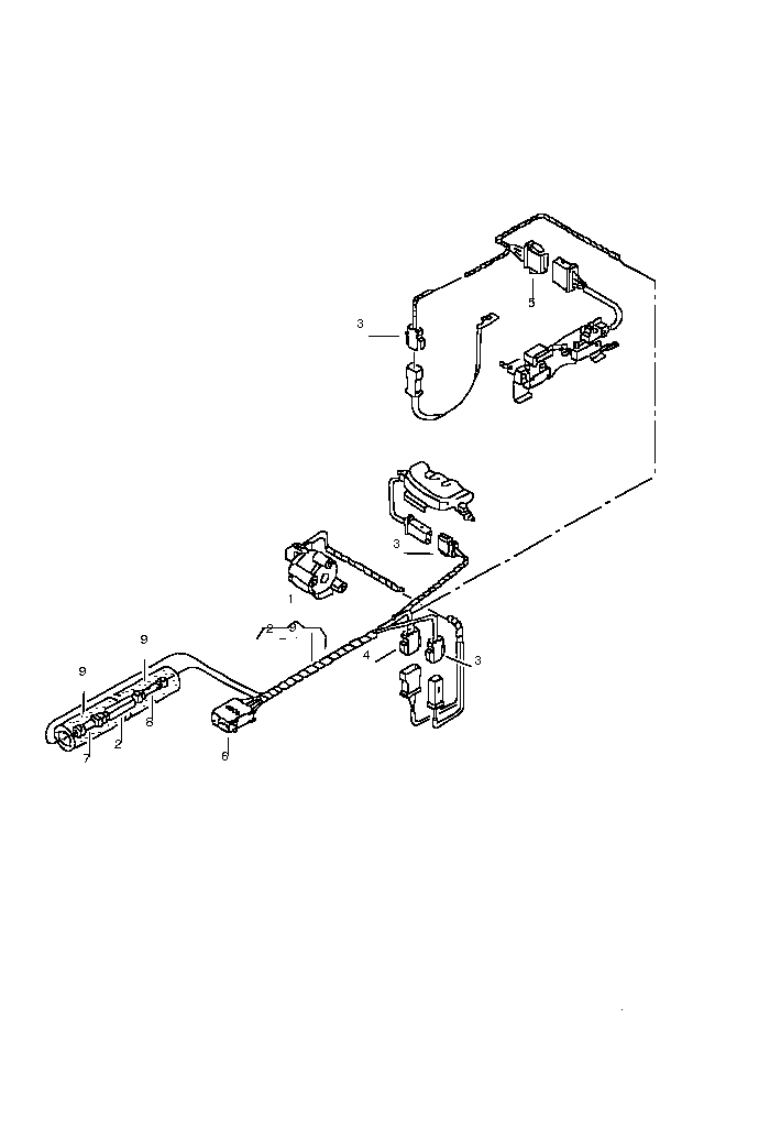

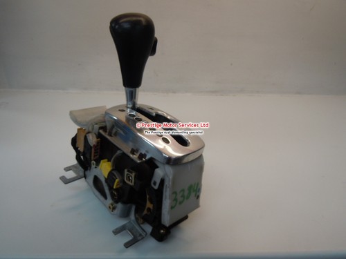

There are 4 parts it could be I guess -
The gear lever selector itself
The Harness for the selector lever (Item 1)

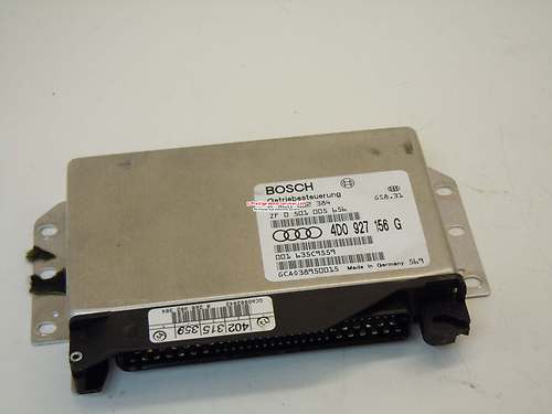

The gearbox ECU itself (item 1 on the pic below)

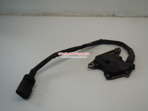

or possibly the F125 switch (item 7 on the pic below)
The F125 switch is something known to fail more often, but you would be best advised to plug in a diagnostic cable and this may well point you in the direction of the faulty item
