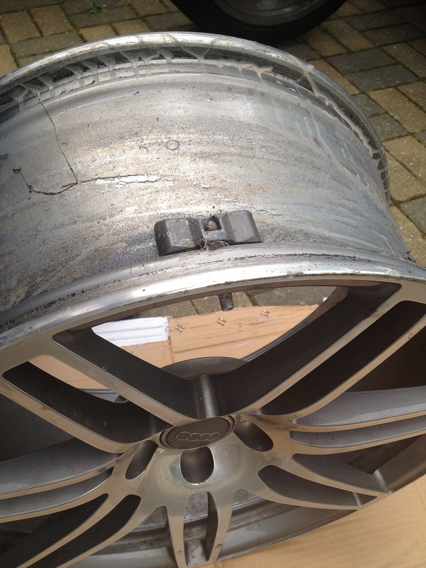

Hurdle #2 is that one of the rims has a serious ding in it. I had the tyre removed to make sure that the ding was only a ding, and wasnt actually a split across the whole wheel, which it wasnt:
Nice to see the Tyre pressure sensors in there, although no idea if they're working yet:

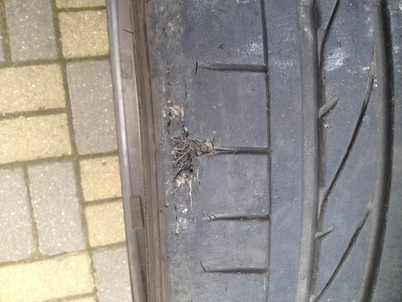

Tyre failure number 1 was due to a large and rather well sealing screw that was straight into the tyre. It would probably have repaired but I'm not a fan of running on repairs, and as I have LPG I have no spare to demote it to...
With the tyre off I was amazed at how light these D3 20" S8 rims are - I've held plenty of D2 rims before, but this was chalk and cheese weight wise...
Wheel number 2 was more interesting, it had a section that was well through the cords. Once the wheel was on the wheel balancer and spinning there was an obvious flat spot just before this, so presumably it has been scrubbing away at this patch unevenly for some time.
Wheel number 1 with the ding turned out to be more square than round, with the inside and outside rims needing serious attention, and wheel 3 was far from perfect.
Wheel 4 was straight and true though. Bonus.

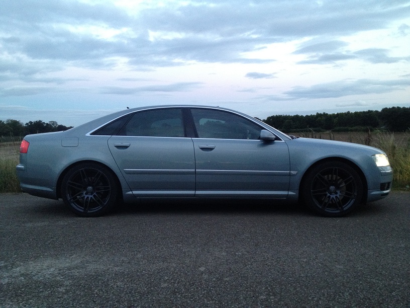

Well, I have got to say, I'm rather smitten.... Dusk was setting in by the time I'd been over to pick the wheels up and pop them on, so I pulled over for a couple of snaps before I made my way home...,...
Opinions peeps ?

Old 18th September 2012, 04:22 AM
IT goes sporty!!
now get the chrome blacked and complete the look
need to see more pics in the light but its amazing how it totally changes the look of the car when you change wheels!
Old 18th September 2012, 07:27 AM
IT goes sporty!!
I'm with you on this one, it looks like a drug dealers car with the dark alloys
Old 18th September 2012, 08:24 AM
Need to see the photos in better light, I'm 50/50 right now.

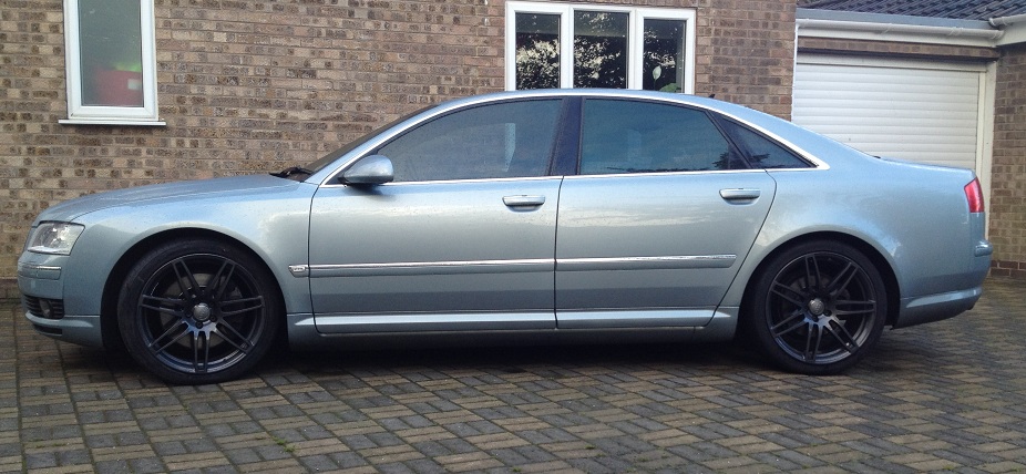

Default Day light.....
