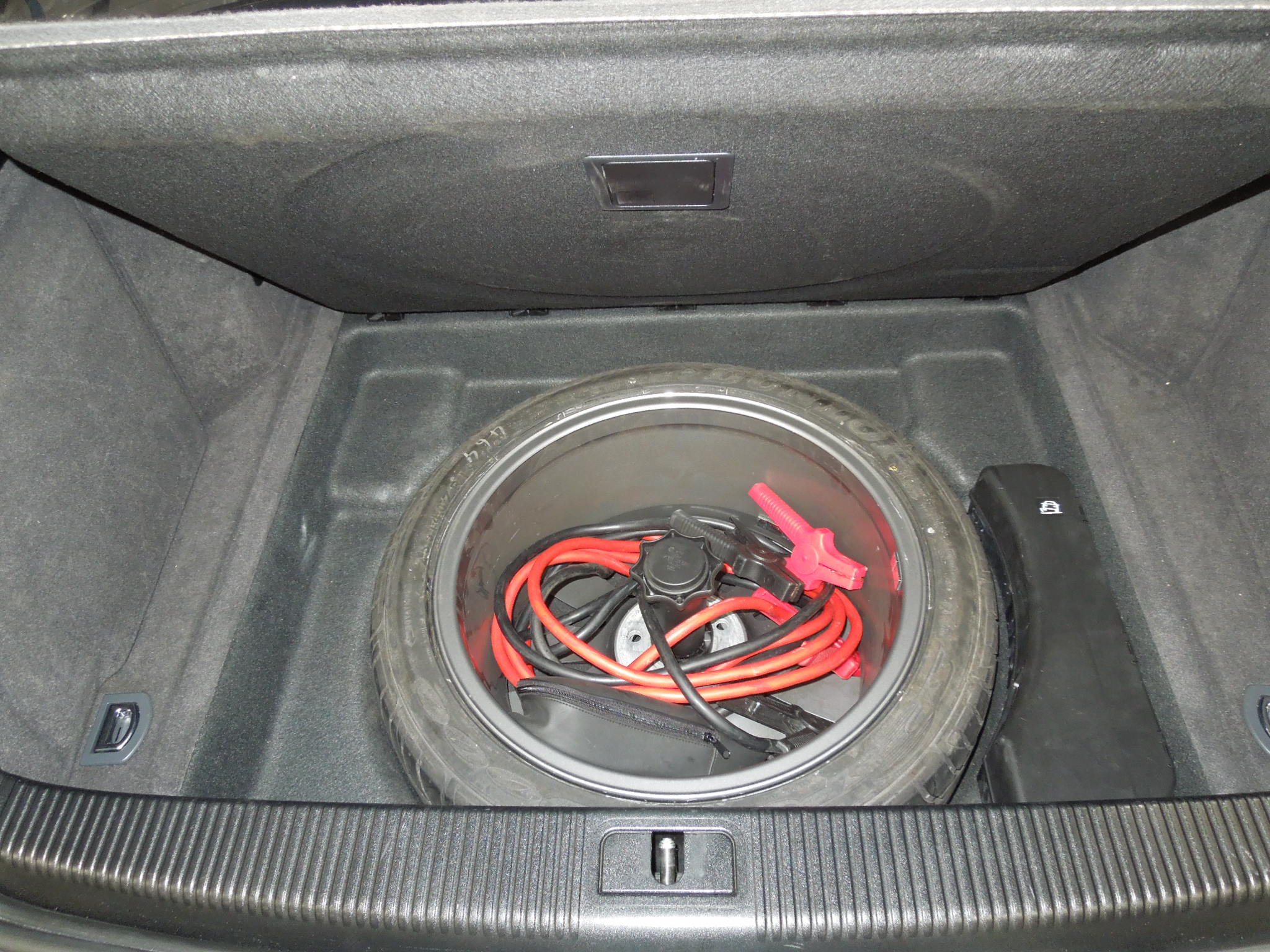

Photos of the carpeted spare wheel well please!
Old 18th September 2012, 09:04 AM
He'll be wanting a little cushion to rest it's head on next!!

Heres the carpeted well, complete with almost clean spare wheel

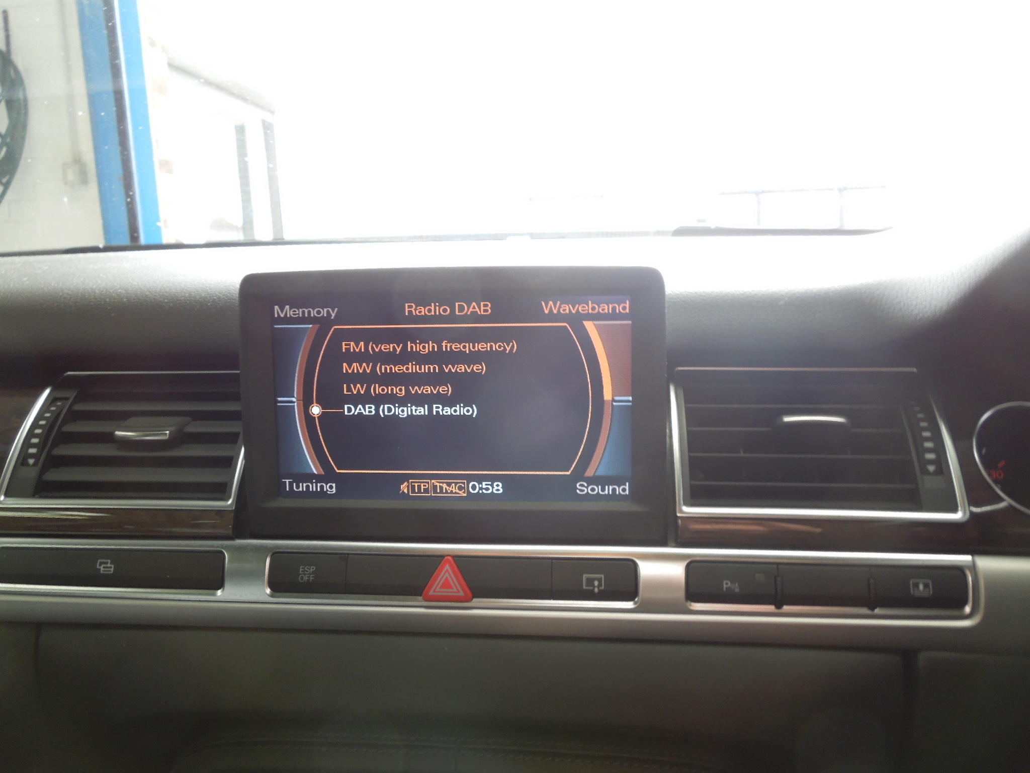

Whilst tinkering on Sunday I also got around to fitting DAB. The hardest part was finding a space to cram it in around all the rear entertainment stuff! Other than that it was an easy retro-fit - change the aerial adapter thingy at the top of the rear screen and run the new aerial cable into the boot, add in another connector on the fibre loop and tap into 3 little wires (before anyone comments (IT) I did use Scotch grips and they do look unsightly, but no-one will see them - I dont trust myself with soldering equipment)
Once plugged in it worked instantly, with no diagnostics necesary - I did go in and add it to the installed list but it didnt appear as though that was necesary - it made me feel better though having another tick in a box! It works brilliantly and hasnt yet hesitated or cut out or done anything un-toward.
