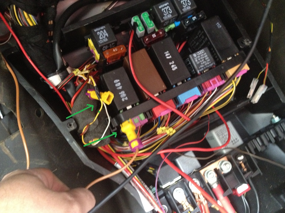

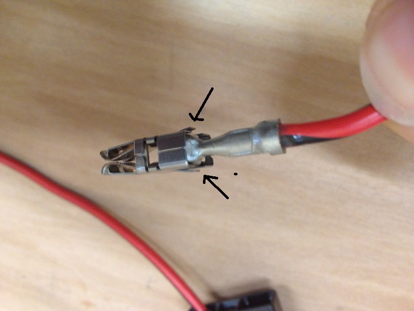

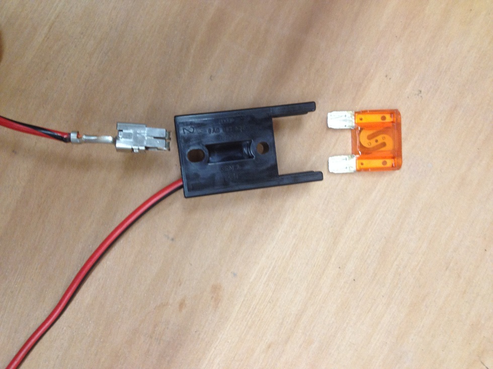

Ok, now I'm a stickler for OEM, and that includes wiring. You can join the wiring, but at 40amps there some beefy connections. Instead, I prefer to remove the connecitons properly and reuse them. The place to perform this is at the blower fuse holder - Leave 1 connection in place on the car, and slot the rest of the retrofit loom into the other connector.
The big fuse block can have its connectors removed with some careful manipulation:

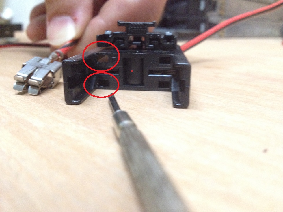

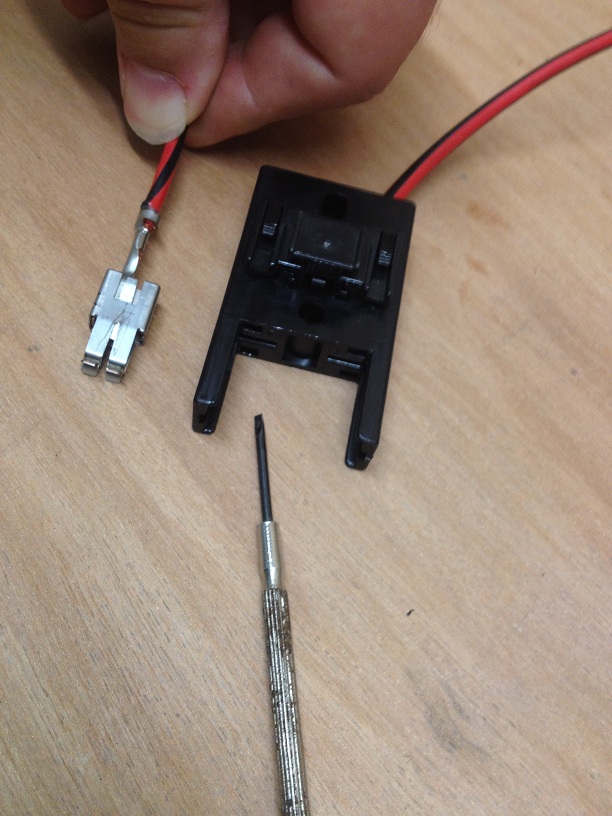

You need 2 flat blade screwdrivers to insert into the tabs below so that the connector can be pulled out gentle:
These are the tabs you are aiming to press down using the flatblade. Once pressed down, the connector will pull out from the casing. Leave the fuse holder in the car, remove completely the small length of loom that runs down the 10mm nut at the bottom of the fuse box.

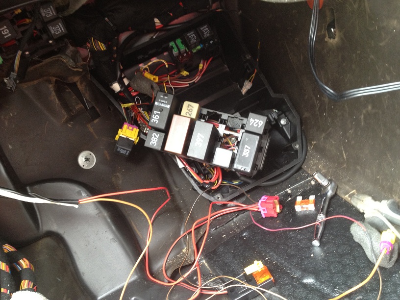

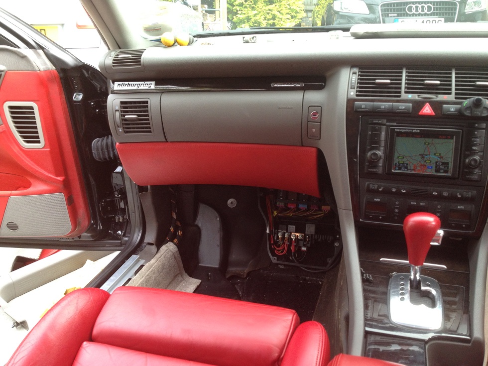

Footwell prepped, stripped back and transmission tunnel covers removed:
You'll need to strip back the roof trims between the middle sunroof controls and the A pillar so that you can run the solar panel connection up the A pillar and into the void above the sunroof controls. This is where the Panel will connect to the retrofit loom.
You'll end up with a bundle of cable in the footwell we'll need to deal with. The main relay panel pulls out with a little care revealing the space where we can install the solar relay

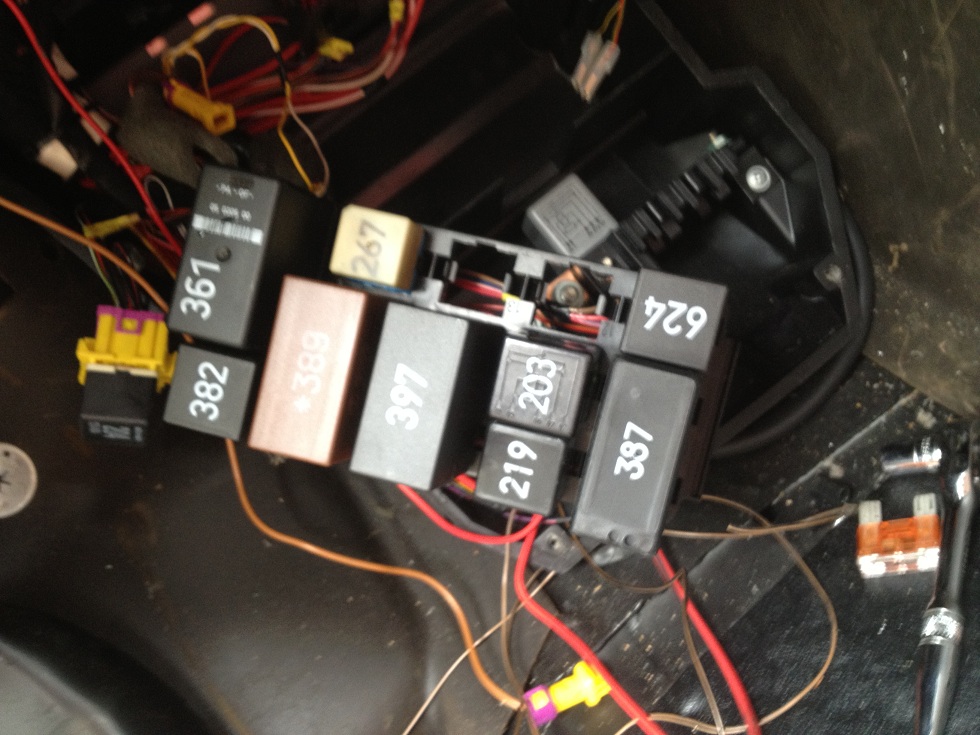

And the relay holder pushed into place. The metal bar is from a pre-wired pre 1997 car, and the solar wiring was present even though there is no solar panel so this bar acts as a permanent bypass to connect the blowers to +12.
Replaced with a relay:

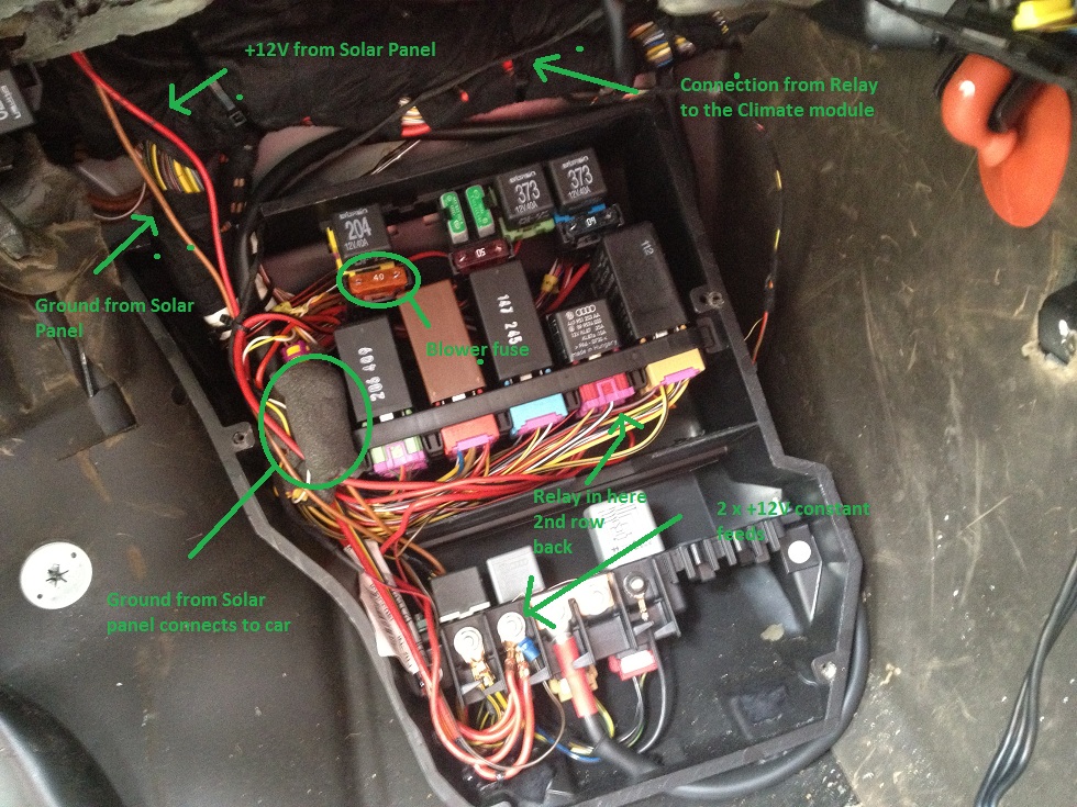

and pushed back into place, and the connector pushed into the 40 amp fuse holder, and it popped back into place
And connect these 2 earth connections together, one from the solar panel, and one on the car - Oddley, this connection is on every D2 - They all seem to be prewired with it.

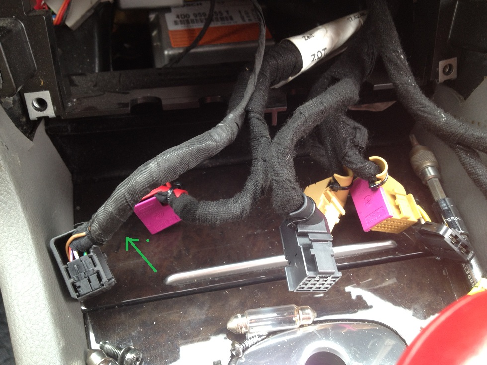

Then onto the climate module. Remove it completely and find the conenctor block A - Note it is not the connector to the far edge of unit, it is one of the 2 connectors next to an edge connector. Look very closely at the unit and you will see the letters.
This is the one we need to connect to the relay back in the footwell. Pin 14 is memory serves me correctly. The wire presses in, then metal clips wrap around to hold it in securely.
All taped up nicely and ready to plug back in:
And pop the climate back in, then we're pretty much done. Make sure the 2 x 12V constant feeds are connected to the 10mm spade at the bottom of the footwell (where the original blower feed came from) and all should be good. Heres a final reference:

If you don't have the connectors, you could do it easily with anything else really.The relay is a 373 which there are a few of in a D2 and the rest is just splicing wires.
Relay part number 8AO 951 253A. The 373 relay that came from Gordon's old S8 with the sunroof, was the wrong type. A million tanks again, Richard.
