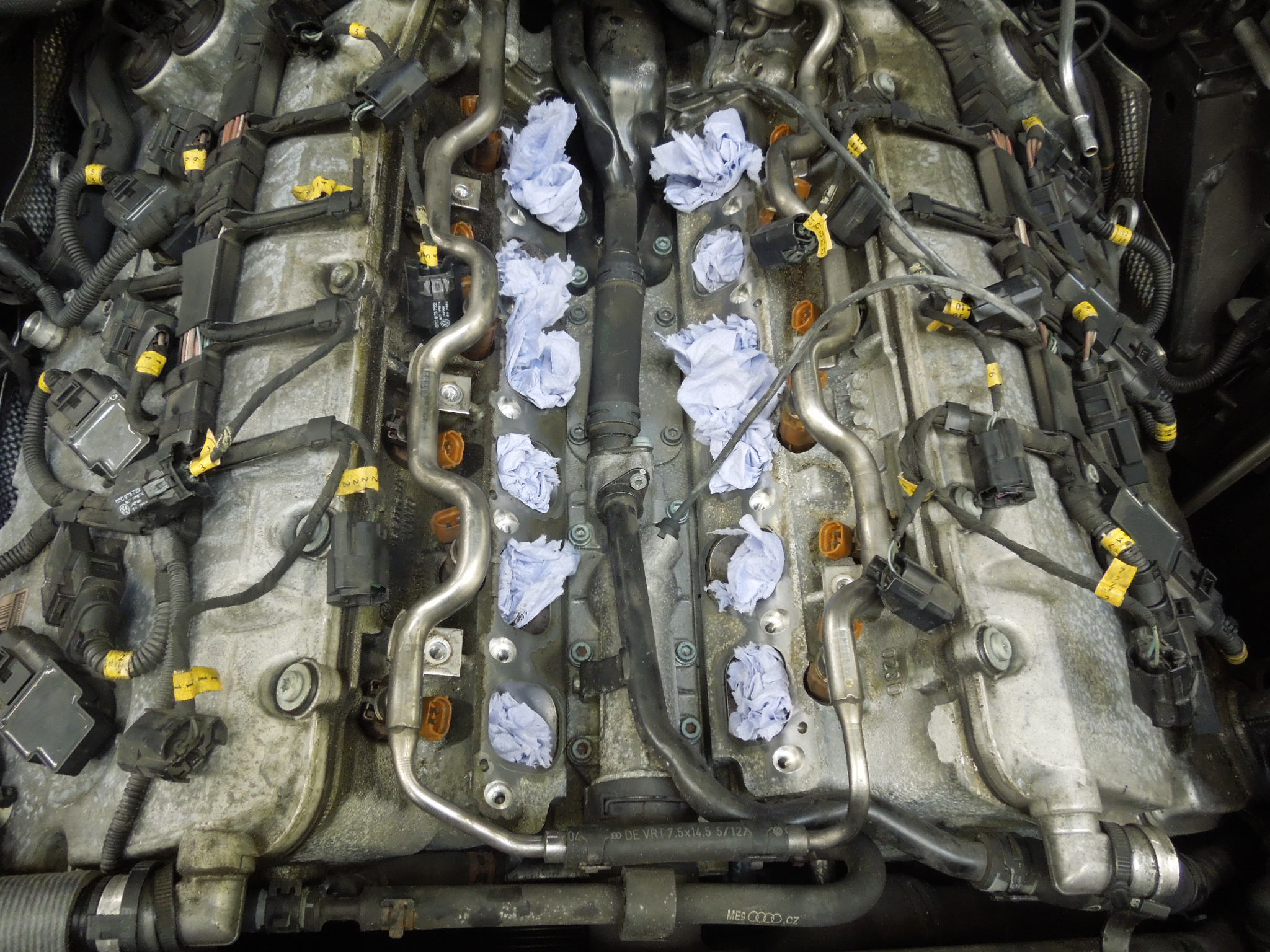

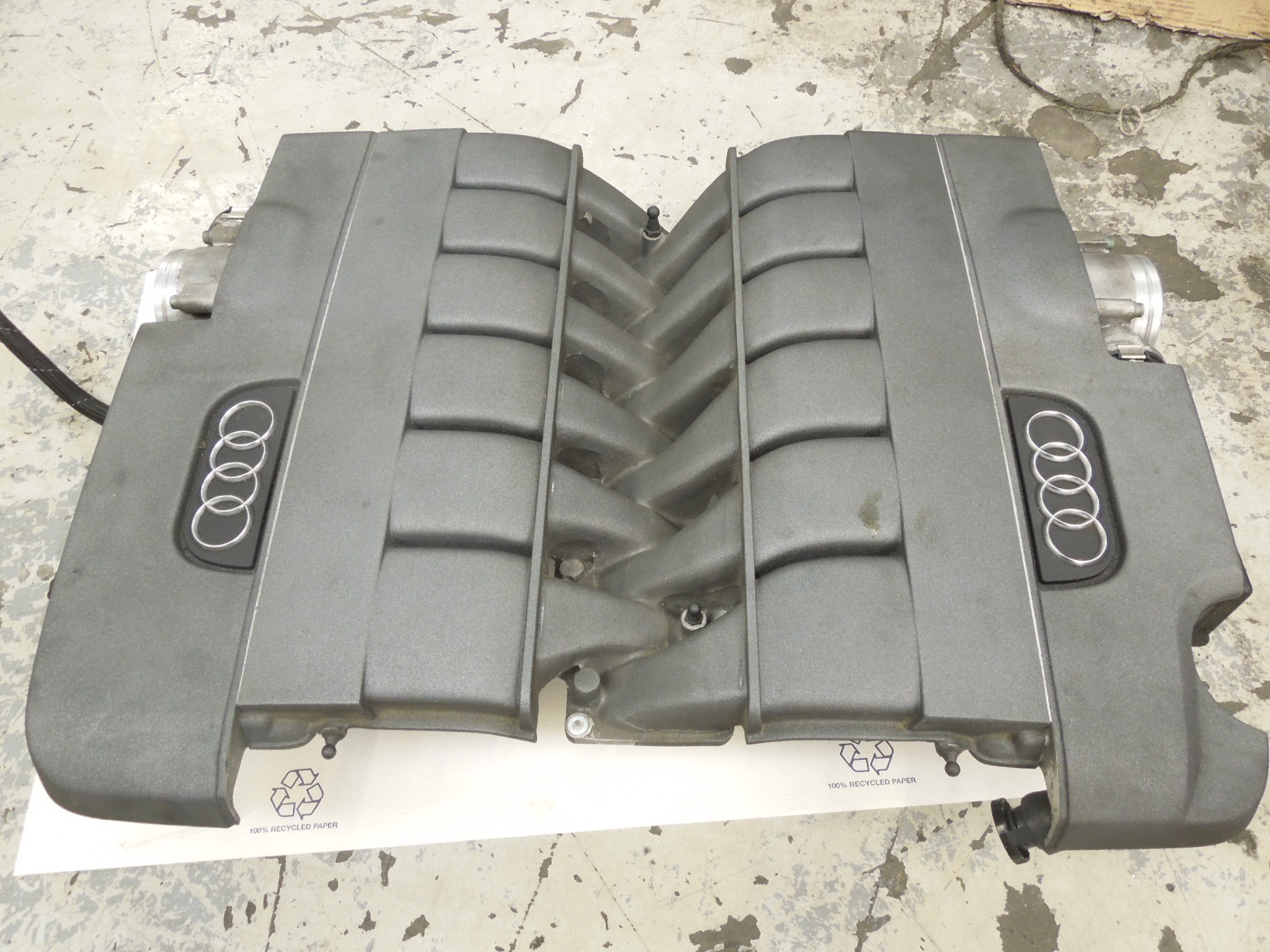

Started the job on a Saturday morning around 10Am and to be perfectly honest it wasn’t difficult at all. I followed the instructions which in a nutshell are drain coolant, remove upper inlet manifold and then remove lower inlet manifold. At this point I was a little nervous about the fact that I could see the valve stems through the inlet ports on the engine so rapidly stuffed tissue into any hole that looked like I could drop something into!
Once this is done the 'thermostat' is visible and can be quite easily removed and replaced. It is a fairly complex affair compared to the simple circular mechanical devices you find on older cars but even so it was a fairly simple swap of a few pipes and one electrical connector.
Refitting is reversal of removal as the saying goes and carefully putting the whole lot back together was more a job of patience than anything else, double checking each hose and pipe was reconnected as it should be (yes I removed the tissue !)

Sorry, not very good with photos, but you will see in one of the pics that the wires to the injectors are labelled with yellow tags. These are put on at the factory so that when you disconnect them you can get them back in the right place. Excellent theory, however, the guy who labelled up my engine loom got a bit carried away with the number 5 stickers and accidentally labelled both number 5 and number 6 injector wires as number 5! Consequently I had a small panic when it came it reconnecting them, luckily it was obvious from the length of wire and the shape of them which one went where.
Sometimes it is nice to see human error on something that you would expect to be so automated.....
