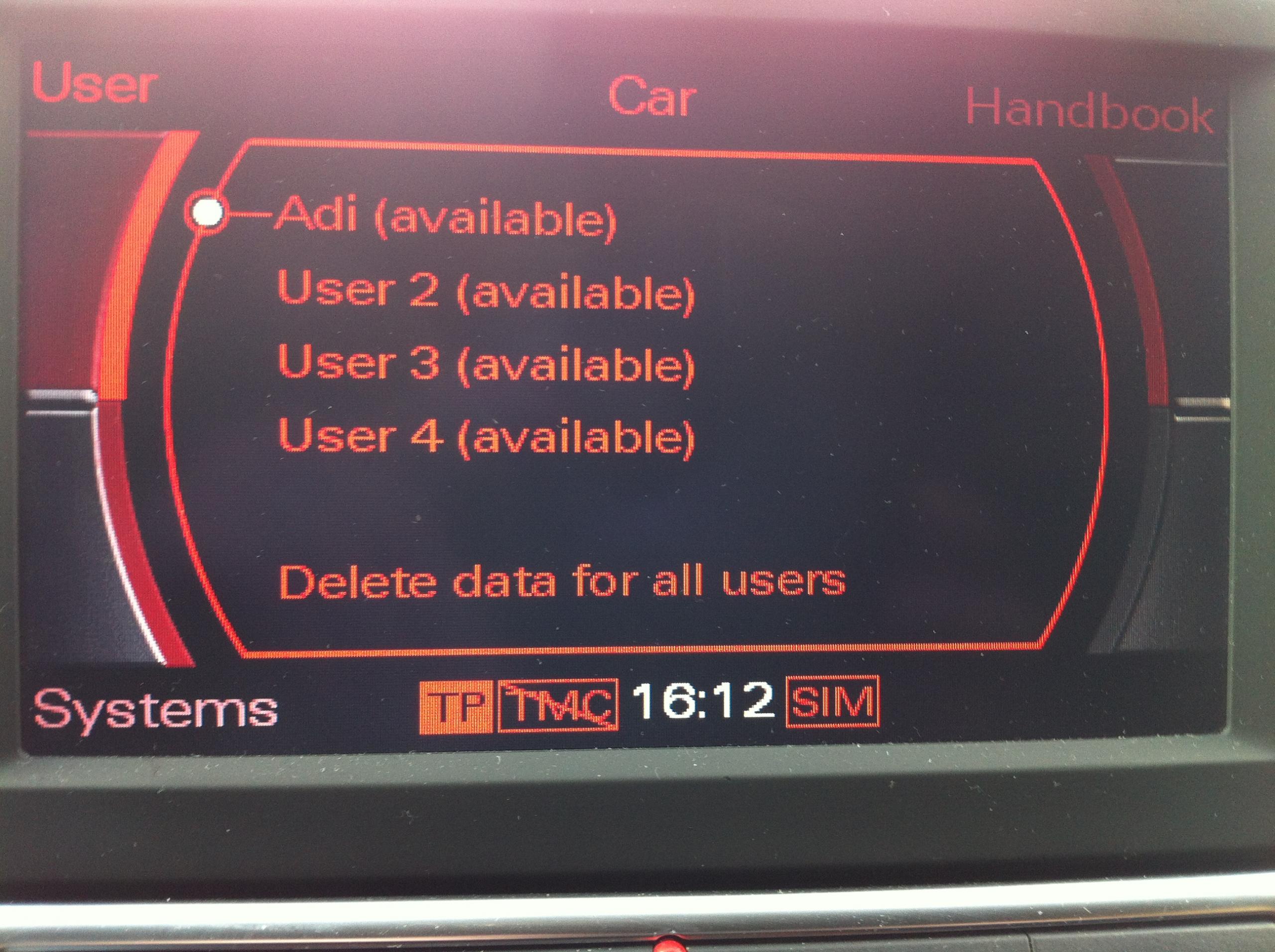

Hi there,
i have some errors on my car and i would like to share with you maybe we can find a solution.
I will copy/paste the errors from VCDS log:

I can confirm the car battery is on 100% also both remote controls have new batteries.
