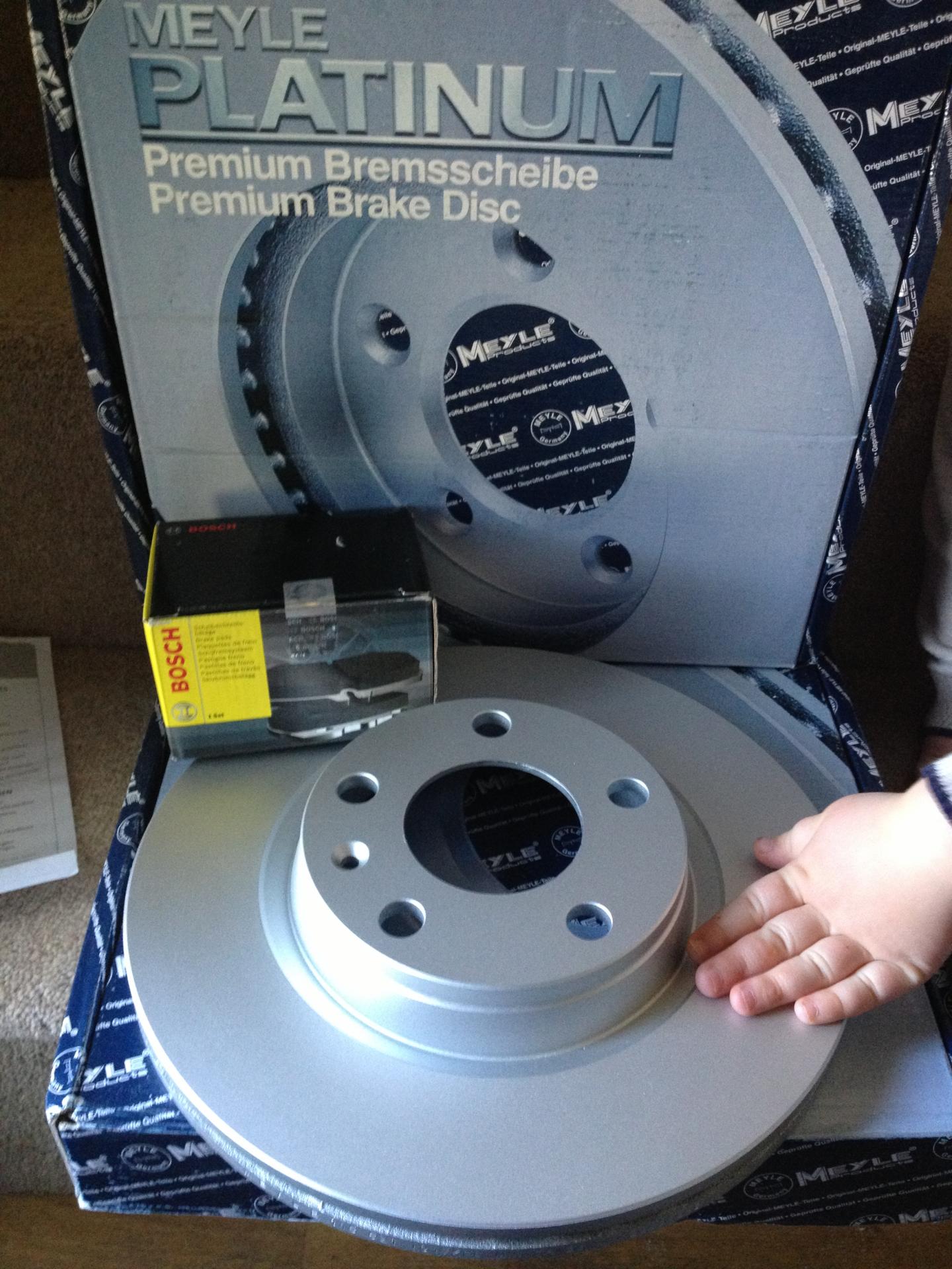

Oil arrived a couple of days ago and brake discs and pads arrived this afternoon
The hands of a 3 year old happen to be in the picture for scale
Discs certainly look nice quality - found some marketing guff online about the corrosion resistance of the discs. Will try and grab a pic of the originals if I remember to tell my mate to keep them for me. Would quite like to clean the lip off and measure the thickness to see how close to 20mm they are.

Service all done - tyres rotated, oil and filter changed, new discs and pads on the back, 4 wheel aligned
Old discs were original, as suspected. Mic'd them at 20.5mm so 3/4 worn according to Audi specs. No longer have the horrid grinding noise at manoeuvring speeds, plus they look a whole lot better!
Total outlay less than £250 so can't complain at that - all good for another year and nothing to report that looks like it'll need attention before then
