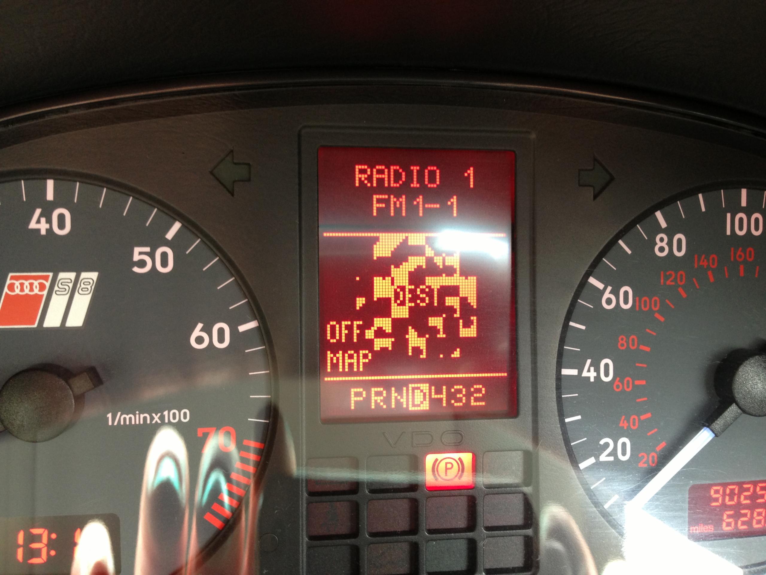

i cant seem to get the satnav to work , i can input a destination ok but then when i set off nothing happems apart from the screen saying "destination" and showing an arrow which changes direction on the screen . when i select route it shows nothing with any relevance to where i am , it looks like it thinks i'm in scotland or something
I also get a warning saying "Position is located outside of the digitised road network"
occasionally the screen goes a bit mad like in the photo .

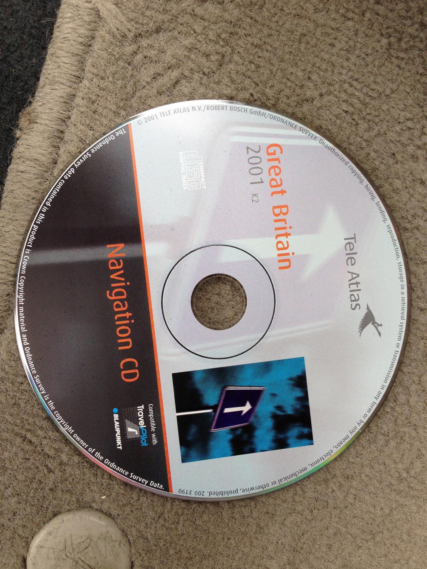

I have a disc inserted which i have also attached a photo of ,

Aerial failed maybe? What does it show as your current position and how many satellites is it picking up?

Done it ,
definitely looks like a GPS arial issue , not picking up any satellite's , so it looks like i'm in for a replacement , can anyone tell me if the disc i have is the most up to date for that system ,

Disc looks like a standard Blaupunkt Tele-Atlas non-DX disc.
The very last version of that is the "2007 Final Edition" which is 2 disks IIRC (England & Wales, Scotland & NI).
You can buy a new one for about £80 http://www.bluespot.co.uk/car-audio.aspx/map-cdrom-uk
Adrian E on here is good at supplying backups.
I could probably do one of Disk 1 at a push but don't have a non-DX system any more to check it on before posting.
