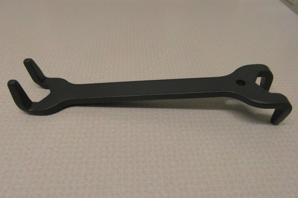

Old 9th October 2013, 07:41 AM
Graynada, do you still have your homemade special tool for the 'bottle lid'? if so could i borrow it for 5 mins to tighten mine up please? I get the wiff of petrol on a hard right turn.
Plumbers wrench from 99p Store fits like it was made for purpose

Old 9th October 2013, 09:54 AM
Sorry mate not that one, the big black ribbed one
