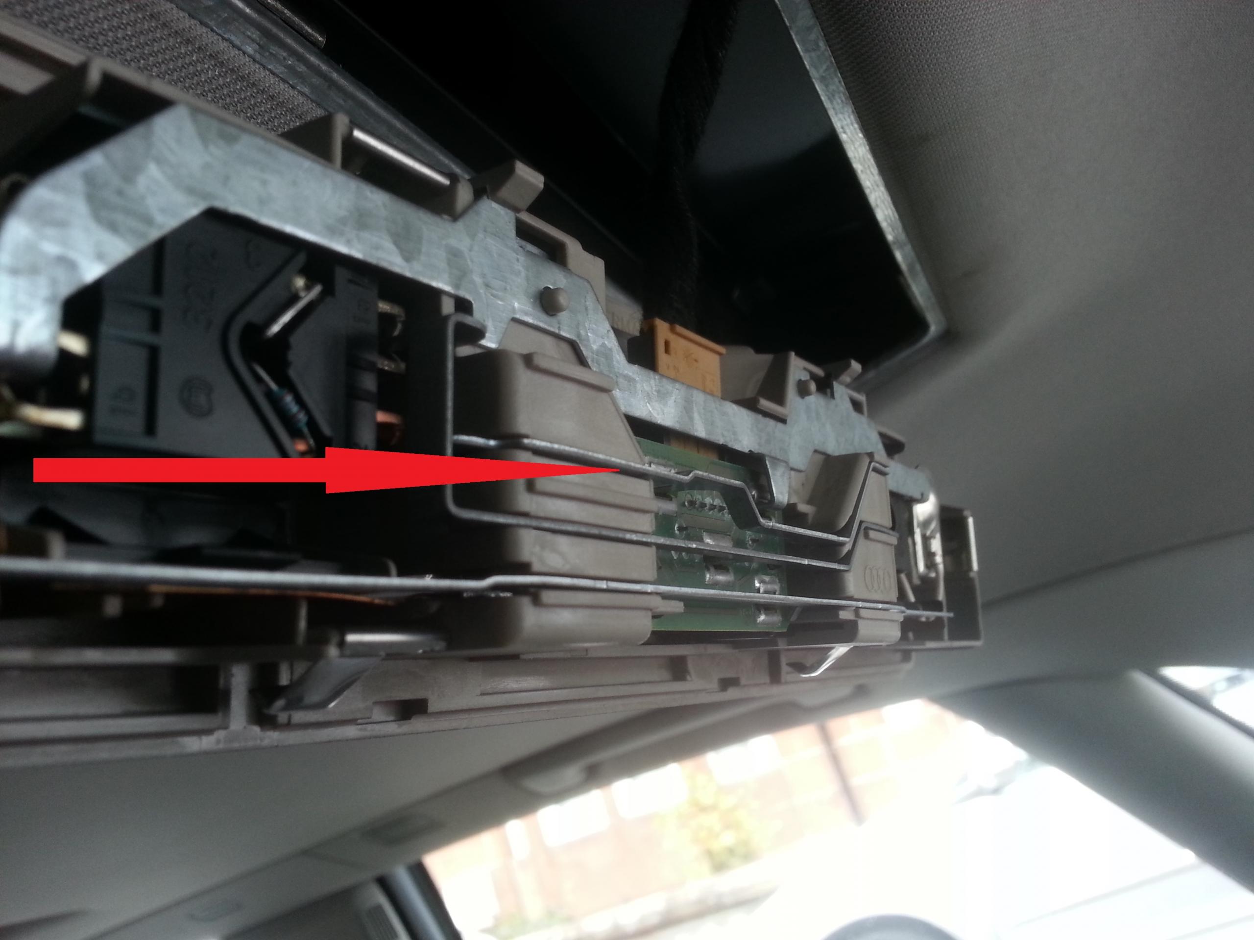

Default Sorted
There's nothing like giving your bits a shoogle to make them work . . . .
After a bit of poking, prodding and pulling, it turns out that the metal strip (arrowed) seems to have been pushed in too far, no doubt after my boys being a bit heavy handed while switching the rear lights on and off. Wiggling it out ever so slightly has cured the ailment.

I've taken that to extremes and dismantled the whole thing as the design of those bars is unusual and seems prone to bad contact.
I made sure they were all straight and properly aligned and cleaned all the contact points before reassembly.
Even after doing that it still misbehaved at times, though (touch wood) has been OK for a while now; in my case nobody is likely to operate the switches so intermittent failures is presumably just down to vibration, thermal movement etc..
