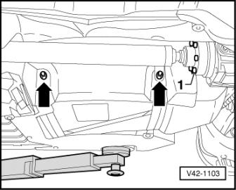

Mark the position at which the propshaft is bolted to the rear differential.
  • → Unscrew the bolts attaching the propshaft to the rear differential -1-.
  • Remove the heat insulation panel in the propshaft tunnel -arrow-.

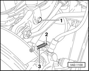

  • Pull out the retaining springs -arrow- from the handbrake cables.
  • → Unhook the handbrake cable -3- from the brake caliper.
  • Press out the spring clip -2- and pull out the handbrake cable to the rear.
Notes:
  • On FWD vehicles the open end of the spring clip -2- should point towards the brake.
  • Do not loosen bolt -1-.

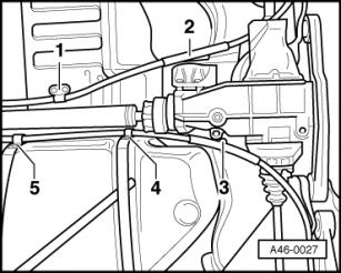

  • → Release retainer -1- and pull the handbrake cable out to the rear through the guide -2-.
  • Release attachments -4- and -5- far enough to allow the handbrake cable to be taken out.
  • Pull the handbrake cable out to the rear through the guide -3-.
