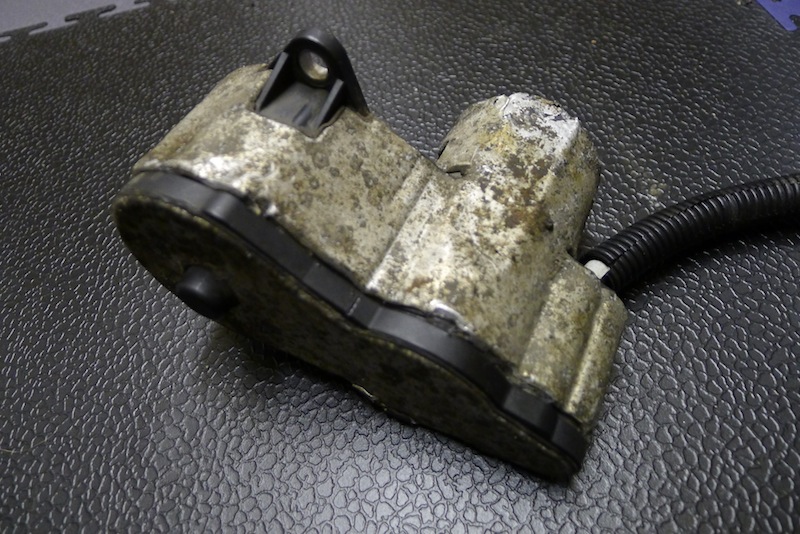

Saying that it might be possible to remove the motor and manually wind the plunger back, but then that would throw up more errors and could cause the ECU to do a wobbly
ID:	6865   Click image for larger version
ID:	6866   Click image for larger version
ID:	6867   Click image for larger version
