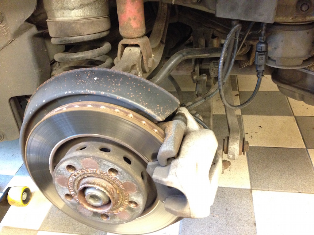

I'll be retrofitting rear pads indicators next time I'll change brake pads.
I always thought that A8s should have brake pads wear indicators FOR ALL 4 WHEELS, not just the front ones -- these are QUATTRO cars after all !
The idea is that armoured A8 D2s came with rear brake pads with wear indicators. Because the same rear callipers were used in armoured and non-armoured vehicles (discs of different diameter but the same width of the discs and the same callipers), the brake pads will have the same geometry as in normal A8 cars, but will come with wear indicators.
Physics: The heavier the car, the larger diameter discs were installed, so that braking pad grabs the disc with bigger leverage, farther from the disc centre, hence better braking efficiency at the cost of faster wear of the pads of course. This is why armoured cars came with wear indicators.

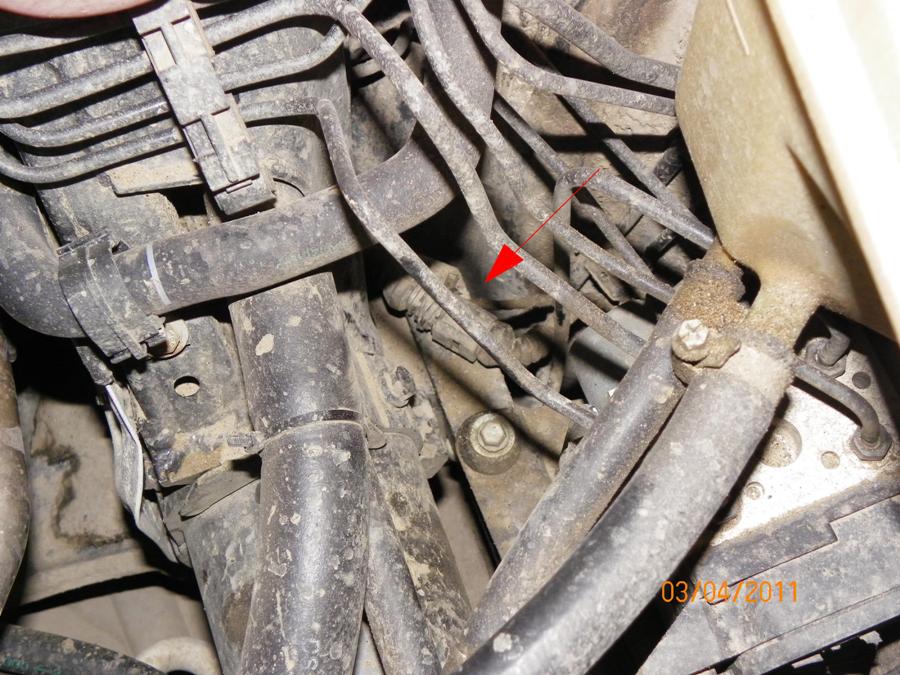

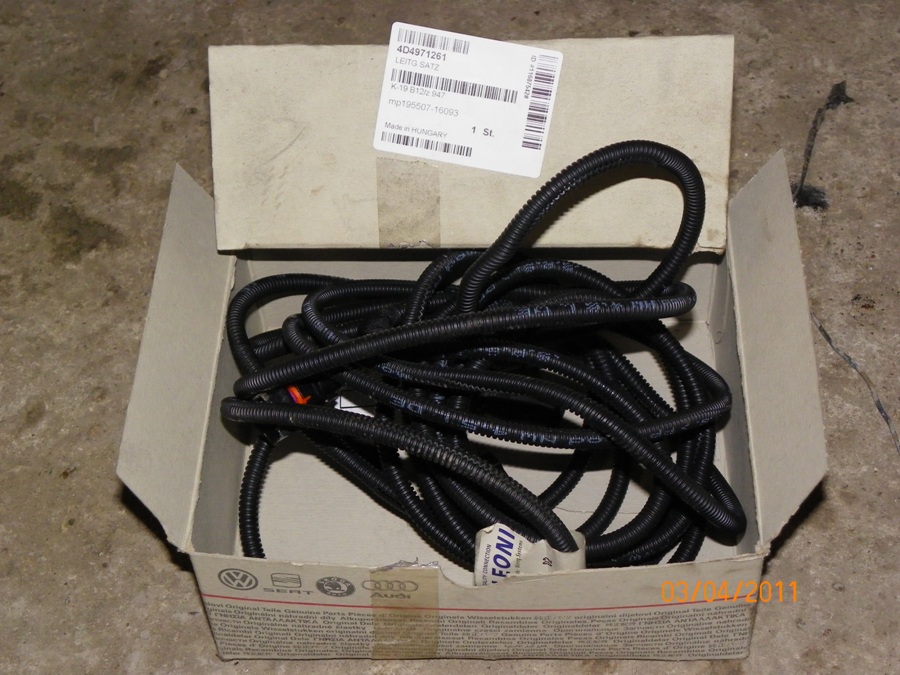

There is retrofit electrical harness in corrugated conduit part number 4D4 971 261 that is designed to fit without having to solder anything. Plug and play into existing wear indicator harness in engine compartment. Connection point D55 in ELSA. There is existing male <--> female electrical connector at point D55. All you need to do is to disconnect that connector and connect harness 'into' the opening, so it'll look like legacy male <--> new female ------ new male <--> legacy female arrangement. Harness then goes to rear axle area under the car and connects to rear brake pads. Electrically all 4 sensors will be daisy chained and connected to the same "bulb" on instrument cluster.
Costs: TPS quotes -- brake pads 4D0 698 451 E: £206.33 (available, but a bit eye watering), electrical harness 4D4 971 261: £53.20 (backorder from Germany).

Connection D55:
Retrofit harness in a box:

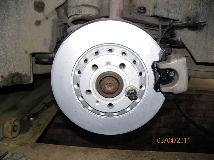

Hi Goran,

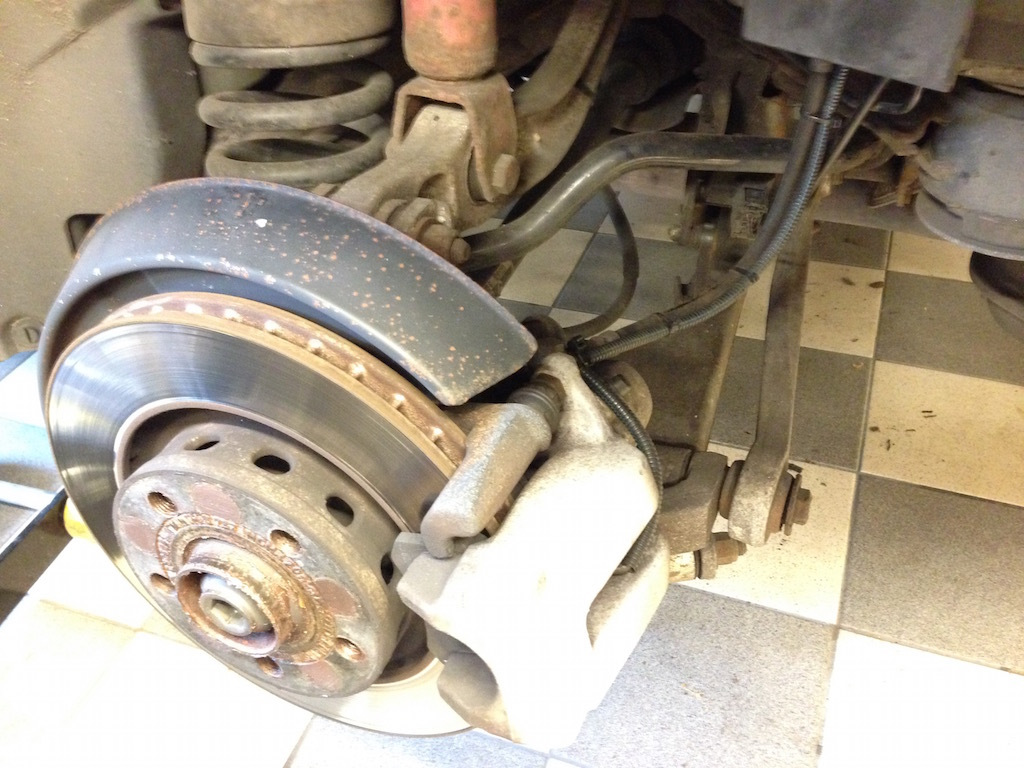

Here is the thread (http://as8.ru/forum/viewtopic.php?f=84&t=18998 -- it's in russian, but use google translate) on installing 310mm rear discs from armoured A8 with some pictures. The guy didn't want the hassle of RS4 install, so went this path with a couple of others. He had to use custom made bolts though, so it's not 100% OEM install.
I personally think normal A8 rear callipers and pads look a bit 'sick' on such a large 310mm disc since not the full surface of the disc is utilised. I think it was Audi's 'makeshift' solution for an armoured vehicle. I DO LOVE thought the brake pad wear sensors part of the story .

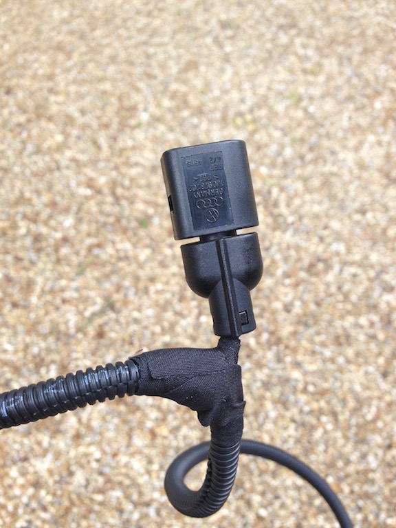

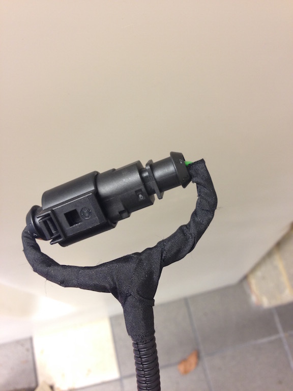

Today I managed to retrofit the rear pads wear indicator harness to my D2. It is relatively easy to do if you have a whole day.
The new retrofit harness is inserted into existing harness without having to cut any cables. All you need to do is to trace wire from the front wear indicator that merges with the ABS sensor wiring in a front wheel arch into a single 4 wire harness and then connects to the main car wiring via a 4 pin connector. All you do is disconnect that connector into parts A and B and then connect part A into part A of the harness and then part B into part B of the harness (see the first picture below with Y type of wiring with two connectors).

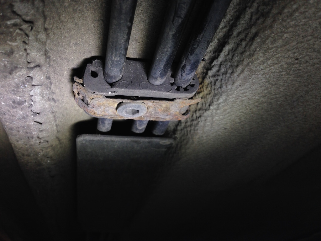

The connectors can be found of both sides of the car so you will have a choice to run the wiring via the left or via the right side. I have chosen the right side as I had a spare slot in the clamps which hold the 3 fuel lines which run from the nose to the rear. The unused 4th slot was used for wiring. I also changed metal part of the clamps since they were too rusty on my car. They cost pennies.

The front side of the 'plug-and-play' connector
which can of course be looped

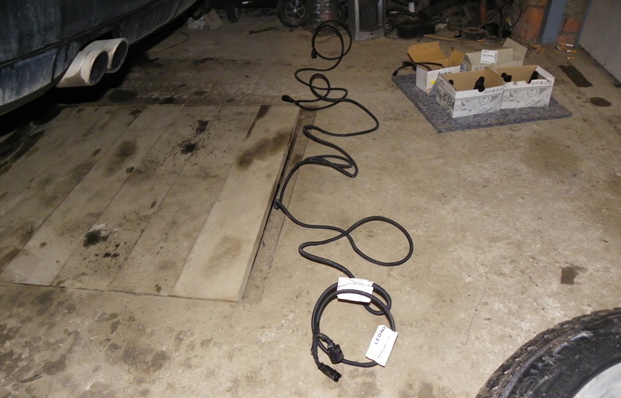

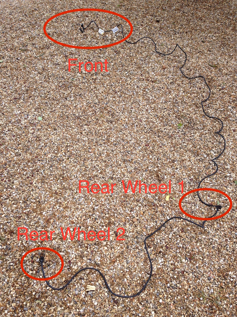

The full harness, about 5m. Just the right size.

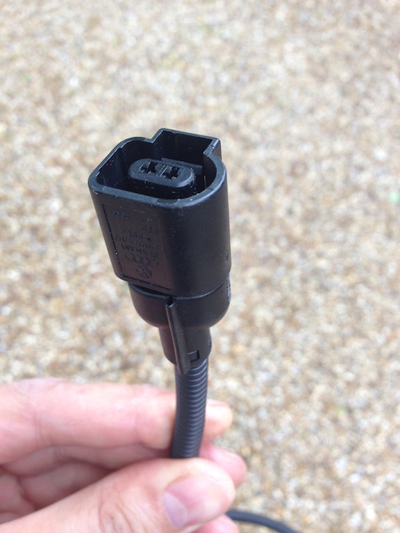

Rear wheel 1 connector
Rear wheel 2 connector
Old fuel lines clamp. Notice a spare slot from the left hand side of the picture
Rusty clamps changed and the wiring fitted now (corrugated plastic pipe on the right)
