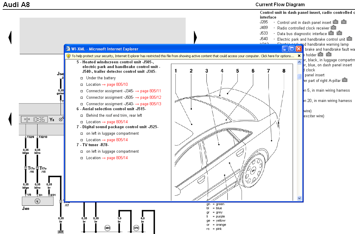

As per the thread title, can anyone help me out with the location of the parking brake ECU? Having some issues with the EPB and wanted to check the connections but having looked at VAGCAT can't actually work out where to look so rather than start pulling panels off thought I'd ask for advice

See attached

Thanks, battery out at weekend it is then
