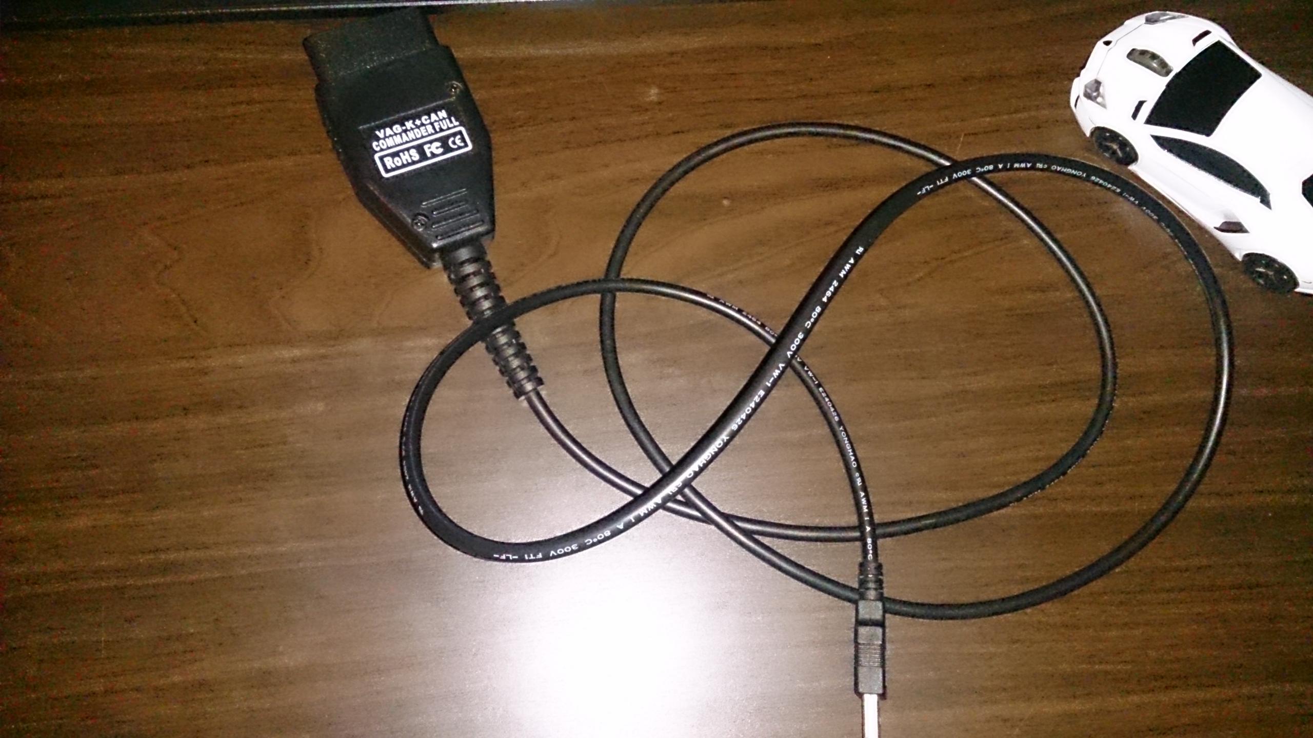

OK, then this should help you at least a little.
PM me your address and I will send you (gift) a spare cable I've got.
It's not a Ross-Tech one, it's a VAG Commander Full, but at least you'll be able to read the DTCs.
I'm sure you'll be able to do more than that, but I never managed to explore this cable and software fully.
You can download software here:
http://www.resettools.com/vag_can_commander_5.1_full
AS far as I remember, you can't use it on a laptop which is connected to the internet, but software doesn't need install so you can keep it on a USB stick and all you will have to make sure is remember to switch off all the internet connections before plugging in the USB stick and running the software.

There is also a USB driver folder when you unzip it, you may have to install it if laptop is not recognizing the cable
Will PM details.
