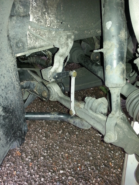

Just took a picture of the headlight self-levelling sensor which I've attached to this post but I'll assume that it is installed correctly. It looks like I'll be crossing Adrian's palm with silver or an offer of something alcohol-based for non-Audi use, of course.

Old 1st May 2014, 04:48 PM
johnny_quattro's Avatar
Join Date: Sep 2012
Location: Wallington, Surrey
Posts: 560
Default 90 bleeding degrees DOH
As subject, revised picture to prevent cricked necks.

I've just met up with Adrian and he hooked up his laptop to my vehicle. There wasn't any value being displayed from the sensor on the NSF. The NSR sensor was working perfectly though. It looks like I'll have to send the unit back ooop north to the forum's sponsors as it was supplied by them a few months back.
Adrian persuaded me to sit on the boot and he was able to see the values changing up and down as expected for the rear sensor. He was also able to wink my headlights up and down under software control which was, as Mr Miggins would say from Fonejacker, 'that's a bit special' lol

The odds of yours failing, and the replacement one being defective are a long shot......
Is there any chance any of the wiring or connector might be suspect ?
Its the same sensor front and rear I believe, if you were up for swapping the two over it might tell an interesting story if the problems moves too... ?
