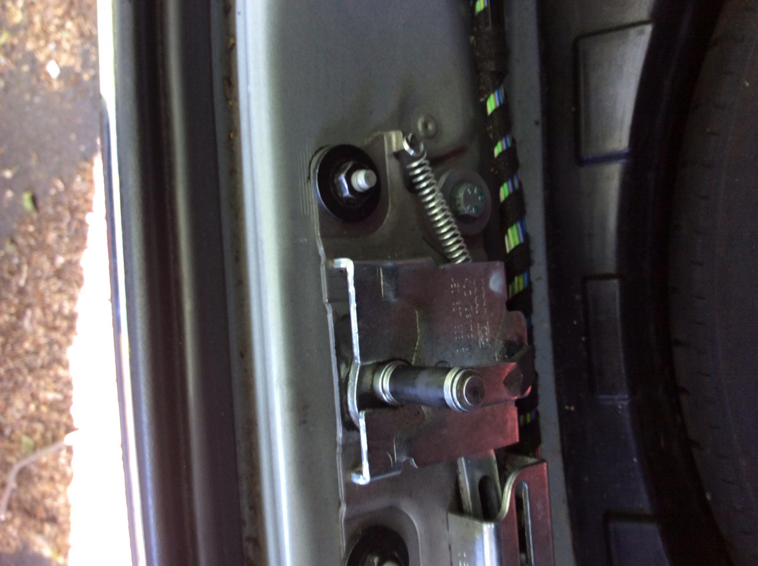

The spring pulls the striker catch back up so that it can catch on the latch when you close the boot, then the motor pulls it down for the soft close.
I still have the boot empty from the DAB retrofit, so will upload a picture in a coupe of mins

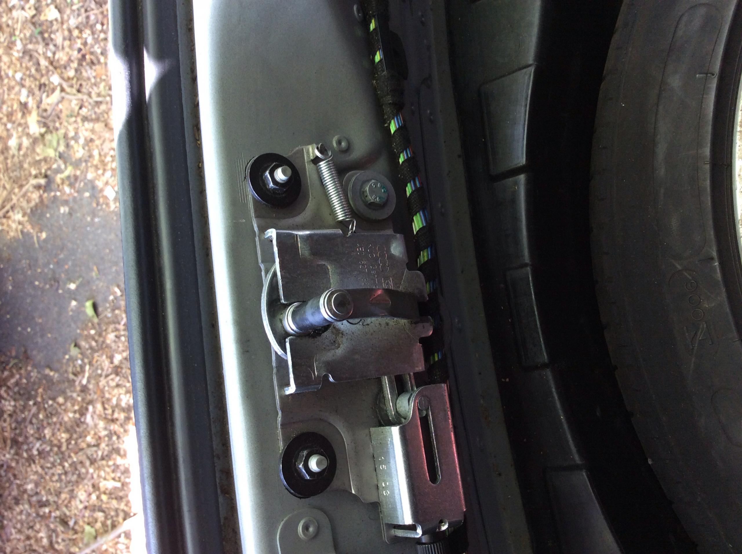

The picture above is with the boot closed, and this one is when it is open, sorry I am on my ipad, so editing is a bit hit and miss...

Interesting.
My striker plate is in the down position and does not move.
Looking at your images the cable that pulls it down goes to the right hand side of the boot.
I wonder if I knocked something off when I was fiddling around with my bumper guide.
