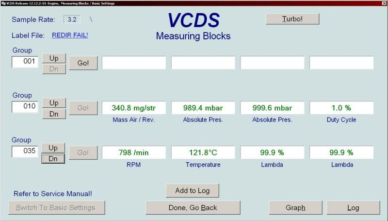

Randomly trying things and stuff with VCDs and the car I started looking at the measuring blocks.
I noticed something that does not look right to me.
First off. What is at -40.5 degree?
Should the lambda sensors all be at 99.9%?
Anyone else not got the label file for 01 - Engine?

Found it.
035 Temperature protection
1) Engine speed
At idle: 720 ... 820 rpm
2) Exhaust gas temperature before turbocharger
At idle: 140 ... 310 °C (with radiator fluid > 75 °C)
At full throttle: 540 ... 830 °C
3) Exhaust gas governing factor
At idle: 99 ... 101 % or 0.99 ... 1,01
4) Overall governing factor
