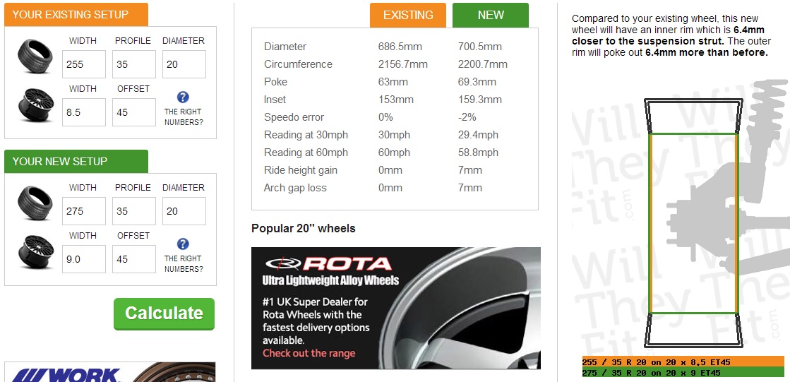

- slightly more comfortable ride because of extra 7mm of sidewall as per picture below?

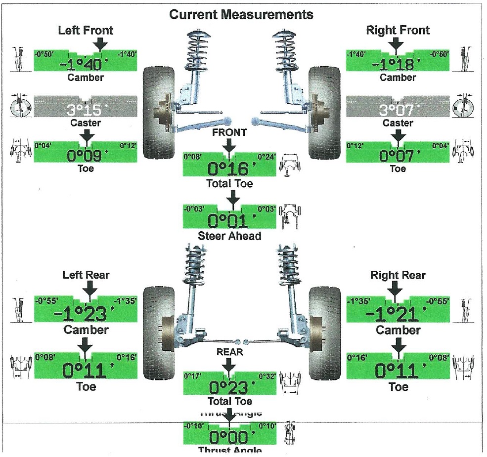

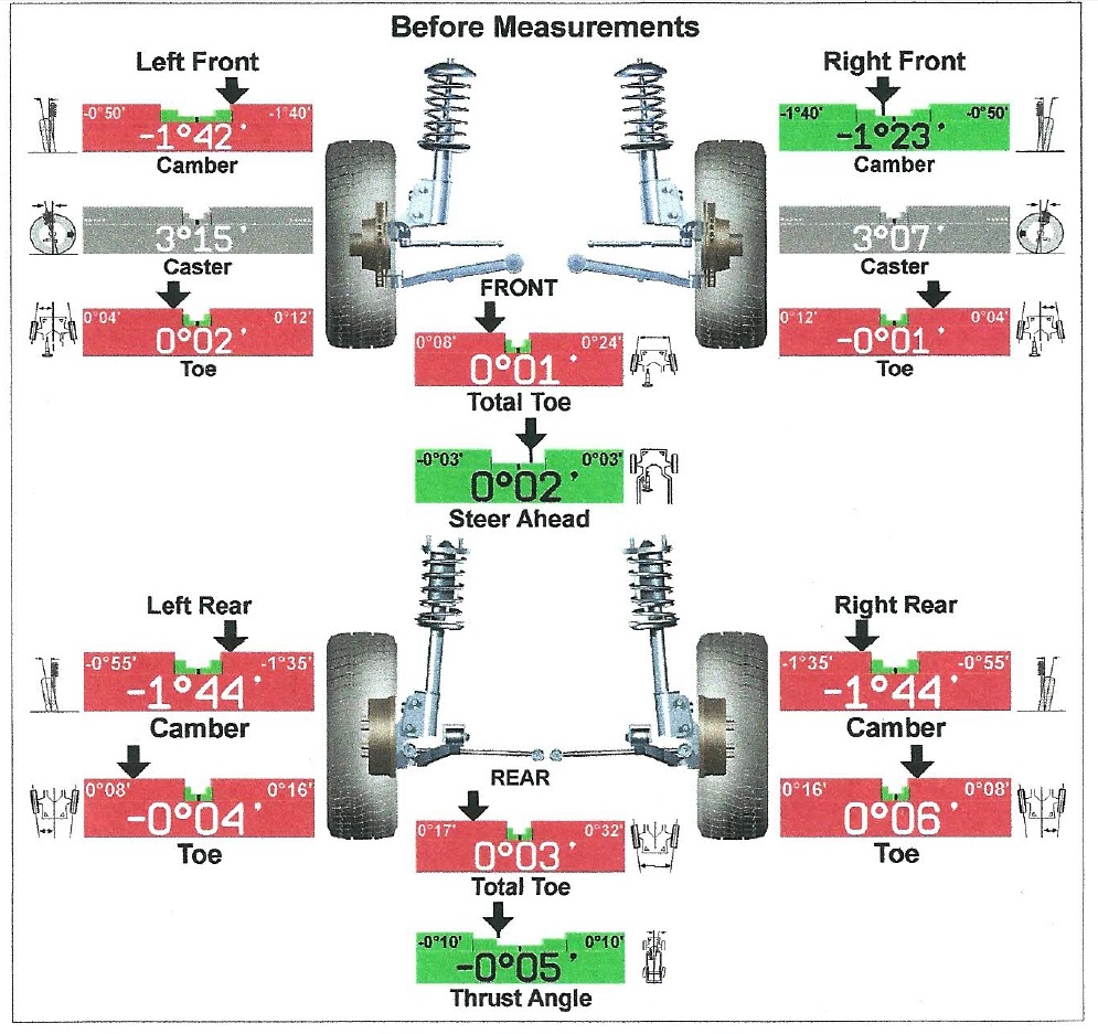

PS. Wheel alignment done last week
ID:	8770   Click image for larger version

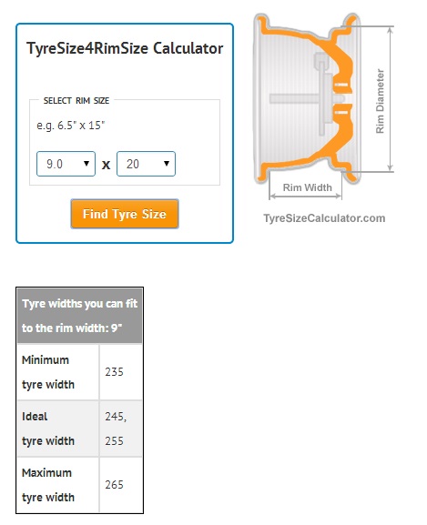

I think the biggest differences will be look and price. Besides from that it looks like 255 is optimal width for 9" wide rim.
