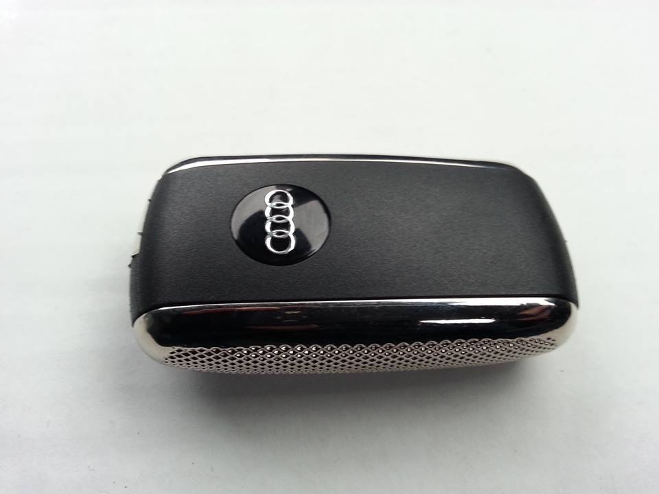

Old 27th August 2014, 08:11 PM
Try auto solutions - Craig Nettleton -
Auto Solutions can supply, cut & program car keys & remotes for about 90% of vehicle manufacturers. They are fully mobile & travel all over the country supplying, cutting & programming car keys so even if you're 200 miles away chances are will probably be in your area at some point.
Within a 10 mile radius it's £80 supplied, cut & programmed for KLINE models such as mk4 Golf, mk1 Leon, mk1 A3 etc. Newer CANBUS models such as mk5 Golf, mk2 Leon, mk2 A3/TT etc are £90. Any further & they have to take fuel & travelling time into account. So if you're asking for a price they need a location so they can work a price out taking into account fuel etc.
They also need to know model & year of car to confirm this style are compatible. If they're not compatible with your car & you still need a spare key They can do OEM remote's.
☏ Call: 07900600548
Email: craigynett@gmail.com
http://www.autosolutions-autolocksmiths.co.uk

Old 28th August 2014, 01:06 AM
ScottD3's Avatar
ScottD3 ScottD3 is offline
Location: Plymouth
Posts: 1,888
Spoke to him about it this long ago and he said he can't do it.
There was more to it but that's the basic gist of it.

Old 28th August 2014, 07:43 AM
Posts: 1,669
The Audi SMART key with the chrome end is quite sophisticated. It stores a log from the car so when you go for a service they pop it into a reader on the service desk and can see the mileage etc...fault codes...if any additional work may be required before they even look at the car.
