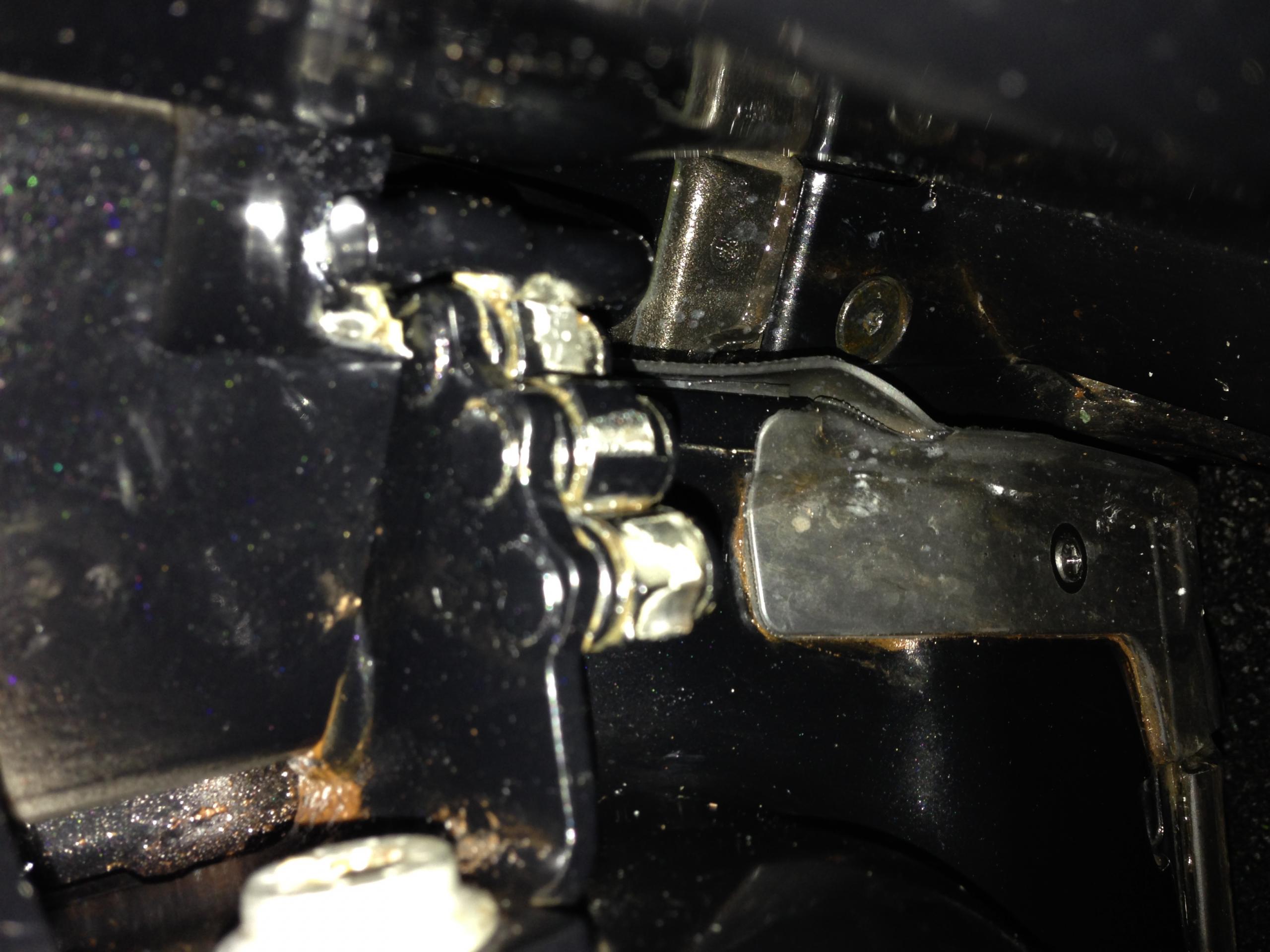

Default Photos
I've taken a closer look this evening, cleaned off all the grease and there are some signs of wear...
Anybody have any comments?
Doesn't look good to me...

Old 27th December 2014, 04:34 PM
dizzlebizzle dizzlebizzle is offline
Posts: 84
Sorry, the photos appear to have rotated themselves once I have uploaded them, not sure how to rectify that...
Old 28th December 2014, 02:39 AM
Do they rotate like the ones in the video i posted or are they seized?
Old 28th December 2014, 09:13 AM
Posts: 84
They rotate, they're not siezed..
