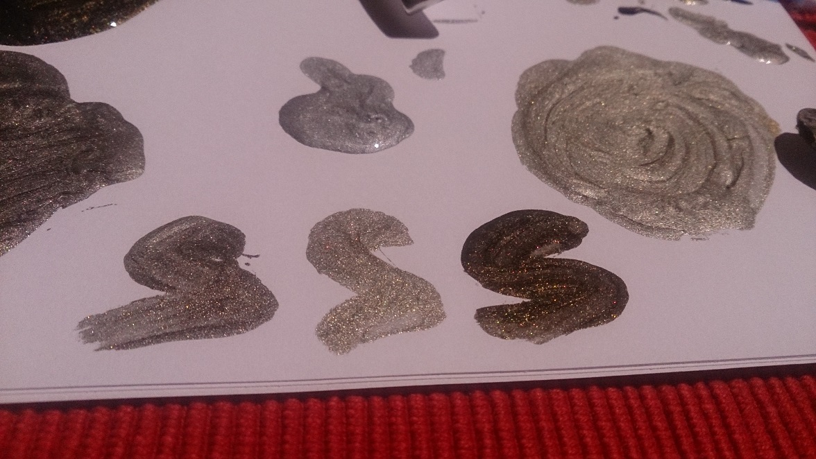

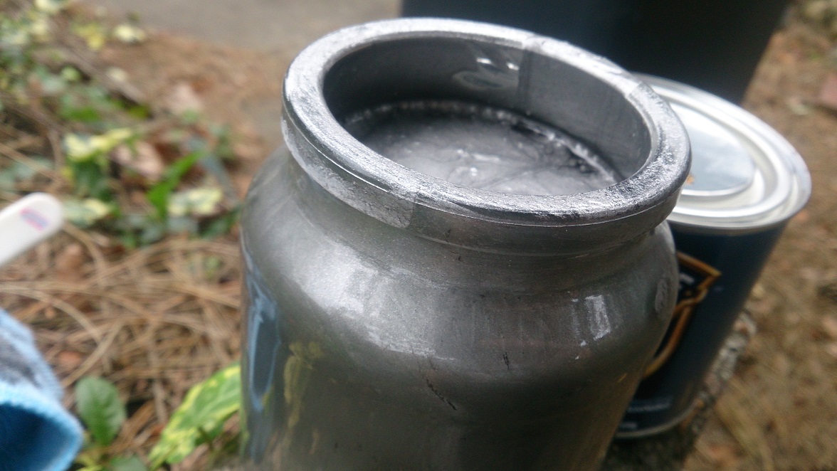

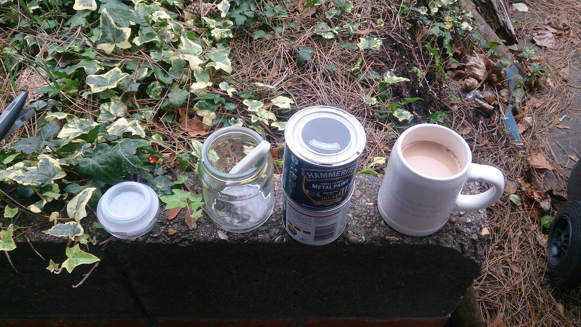

So, after testing some different finishes with black silver and gold colours I have decided to go for dark silver mix, can of black and approx 3/4 of silver
You will need two mixing pots, one for your paint and one for your tea as you will need plenty

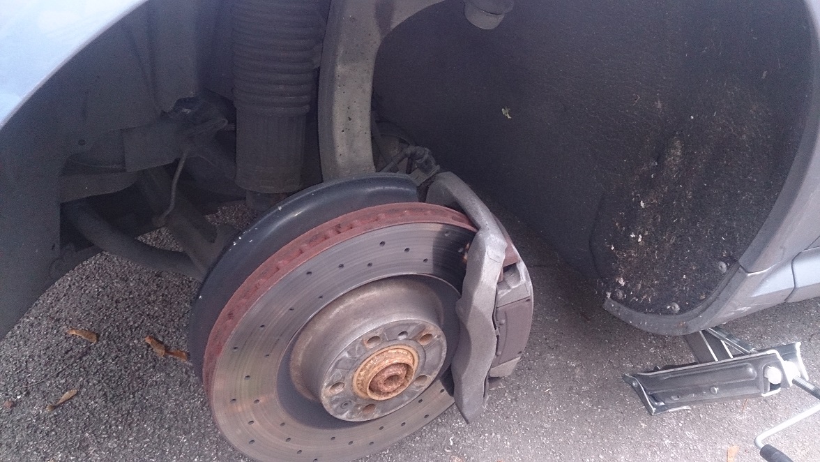

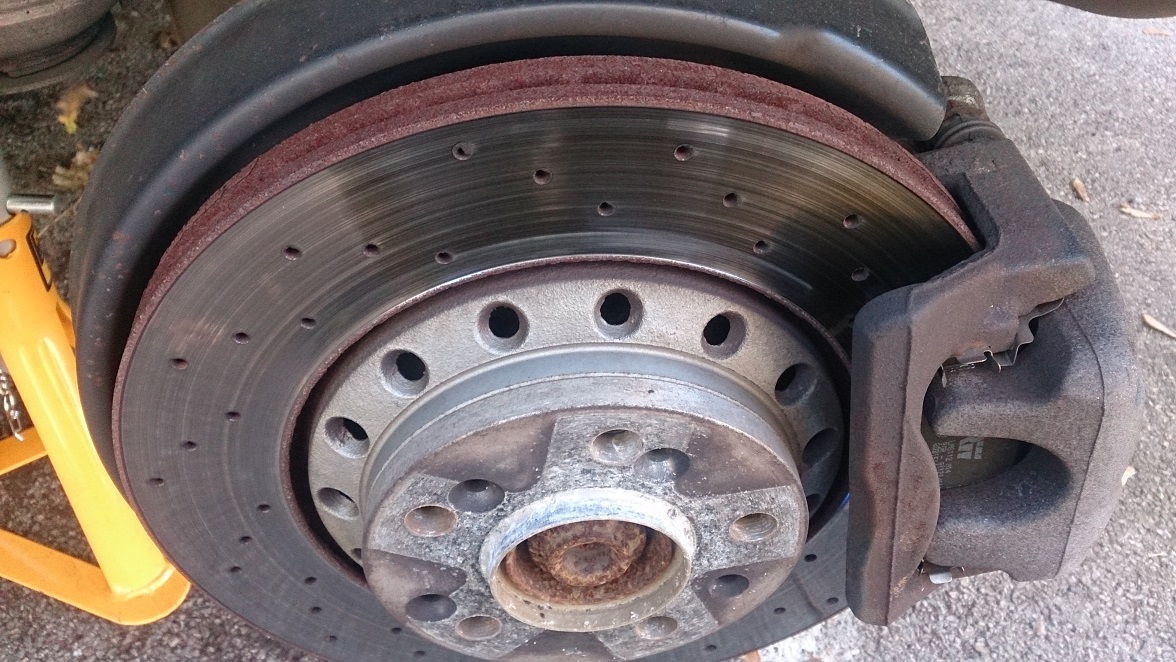

Day 1 (Sunday)

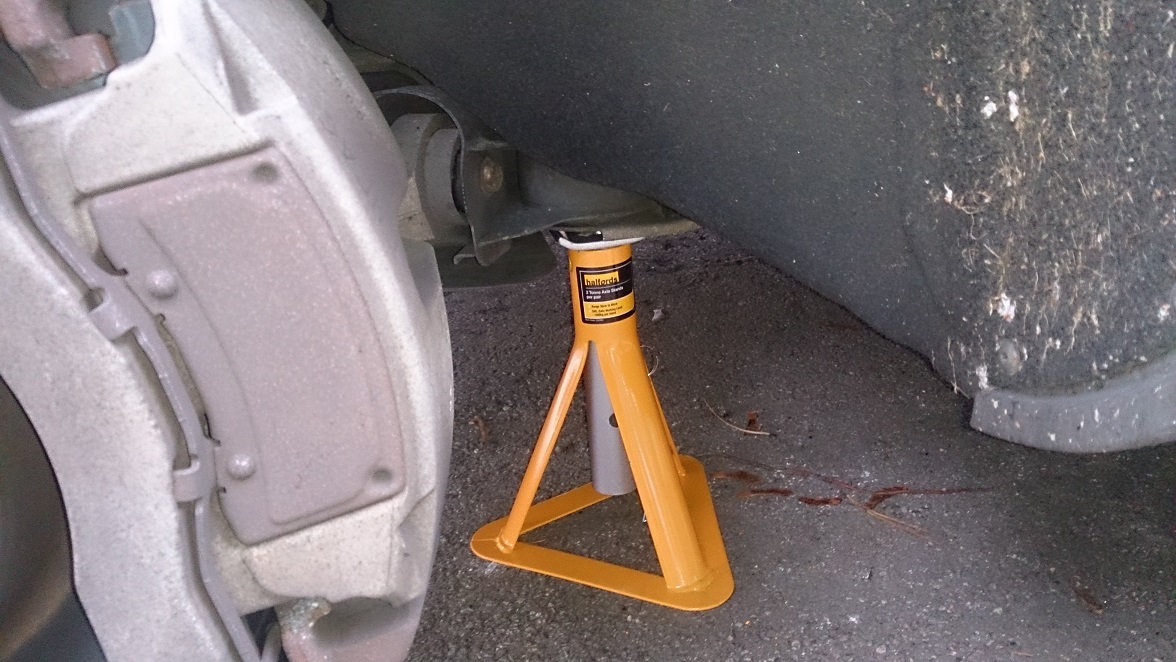

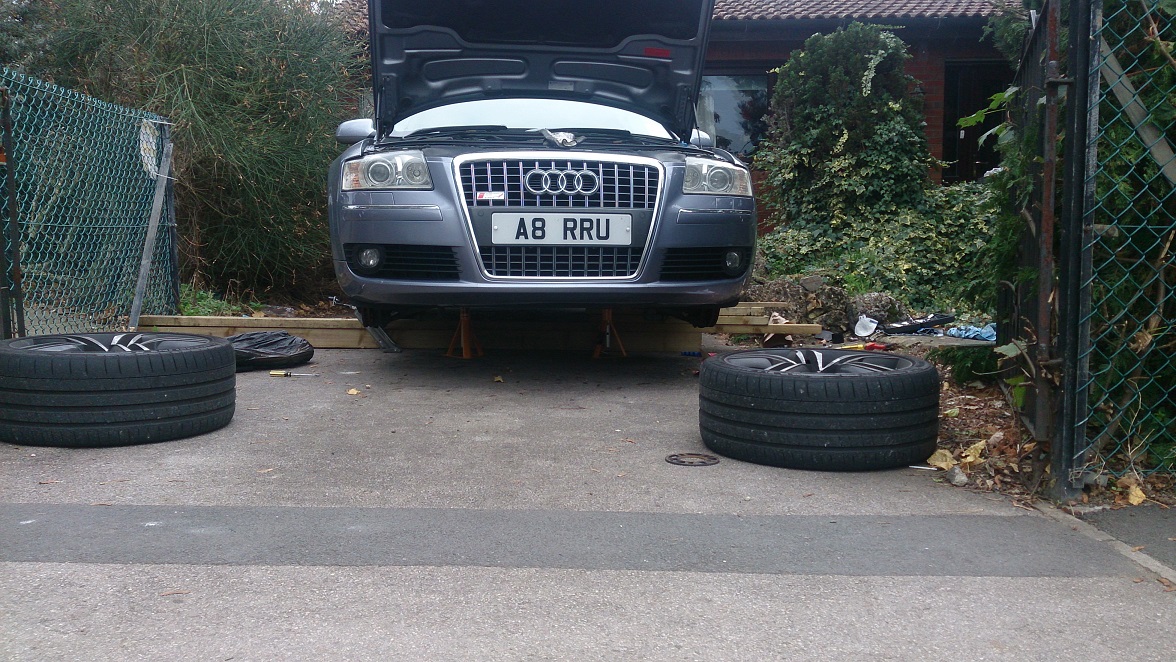

DO NOT FORGET to switch ON JACKING MODE
Place the stands under the sub frame

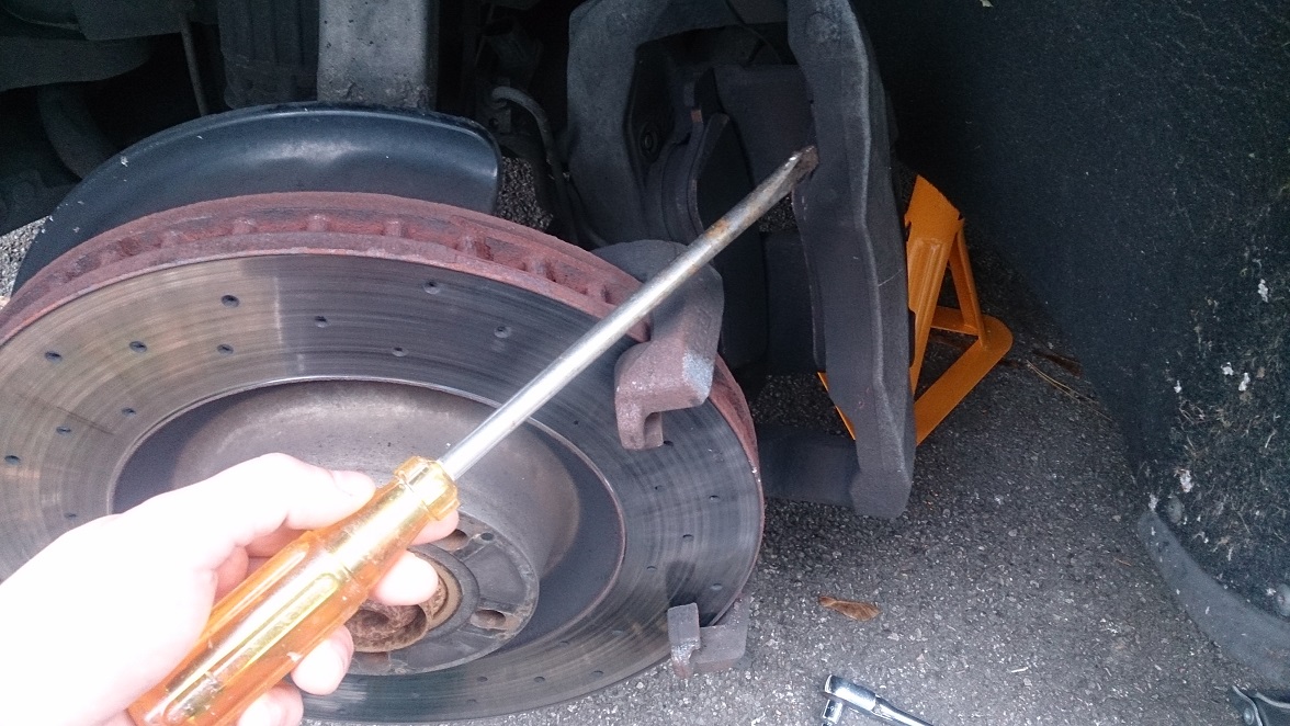

I have purchased a brake caliper tool set before doing this job, but I just couldn't be bother with it so I used a flat head screwdriver to push the pistons in while caliper was still mounted onto the carrier

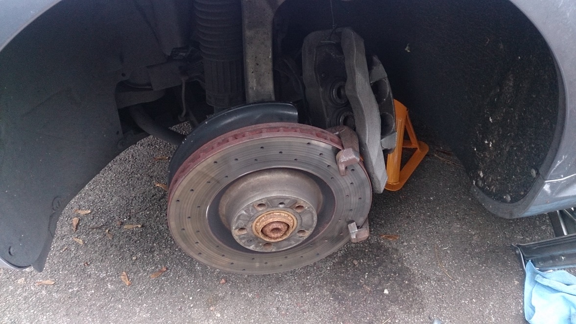

At the back of the caliper there are 2 plastic caps. Brake pad sensor wire actually is clipped to the top one as per picture below, and the 2nd one is just a blank cap at the very bottom.
After removing them you will find an allen key bolts which you will have to unscrew in order to remove the caliper
Then use the steel wire to hang the caliper on one of the suspension arms

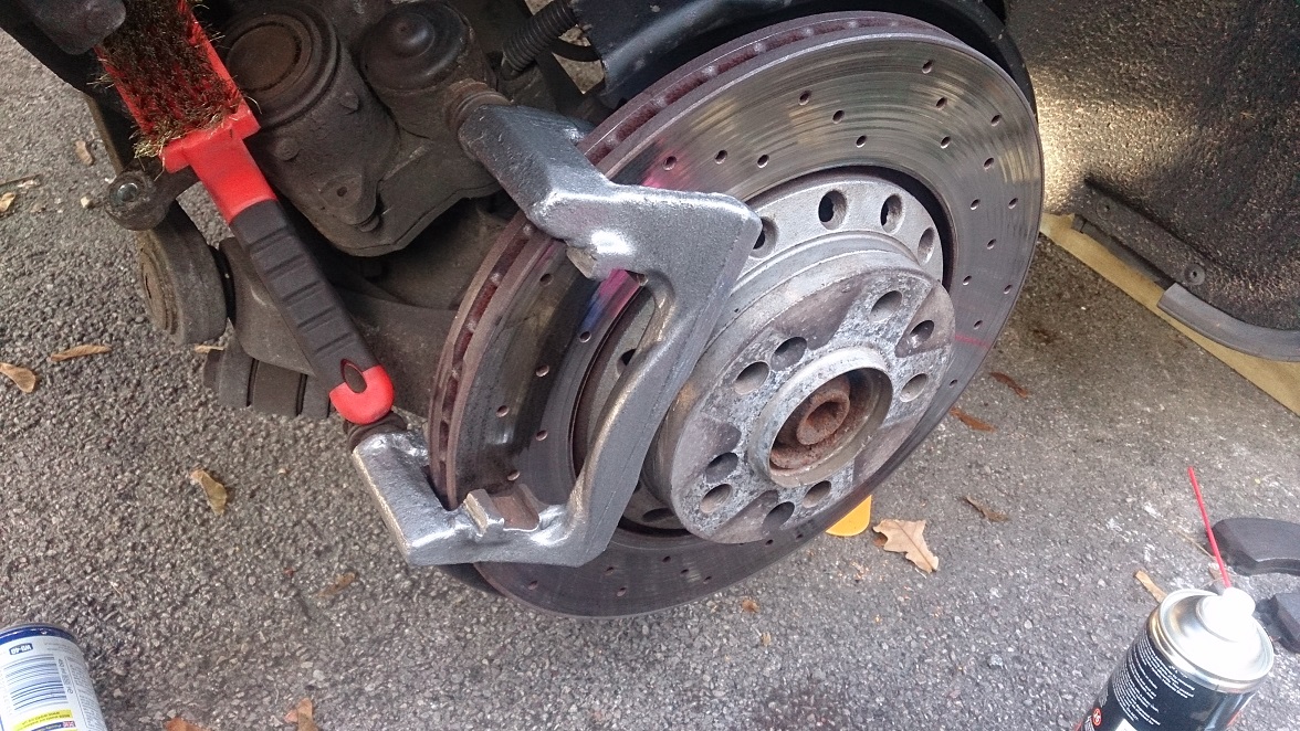

Now you can crack on with cleaning the carrier plate and caliper with wire brushes.

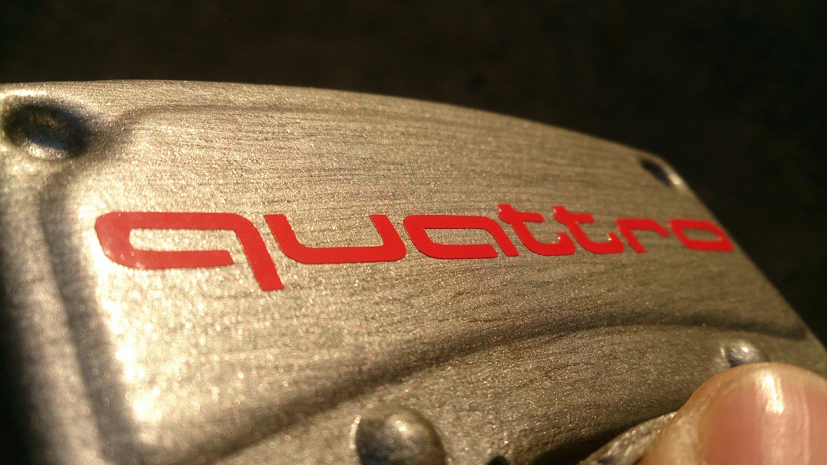

Then today (Friday), these arrived. Yes yes red will draw attention too much, but after a long chat with Scott during the whole project, it was worth trying.
I did ordered a set of black ones as well, but at the minute I will stick with red ones.
They don't scream so much: ''Look I am quattro''

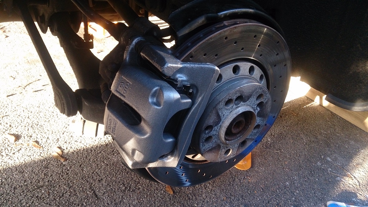

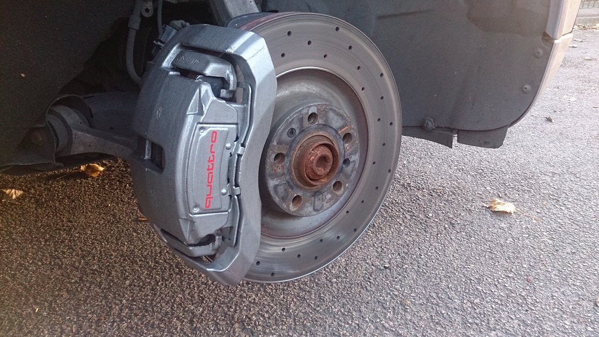

So, now some before and after photos. Tomorrow after a wash I will take few shots with wheels on.
BEFORE
...aaaand AFTER
