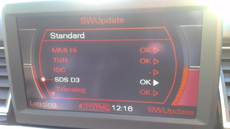

I did get this error when doing the updates.
IDC is CD changer but I'm not sure if IDC1 is the changer it self or the Dension kit.
It also displayed this.

Old 3rd November 2014, 02:11 PM
mannyo mannyo is offline
Location: Blandford, Dorset
Posts: 1,974
Would not worry about IDC1, as you say its most likely the dension kit which cannot be updated this way anyway.
Any missing options can be added back in from the hidden menu, several of mine were missing as well.
