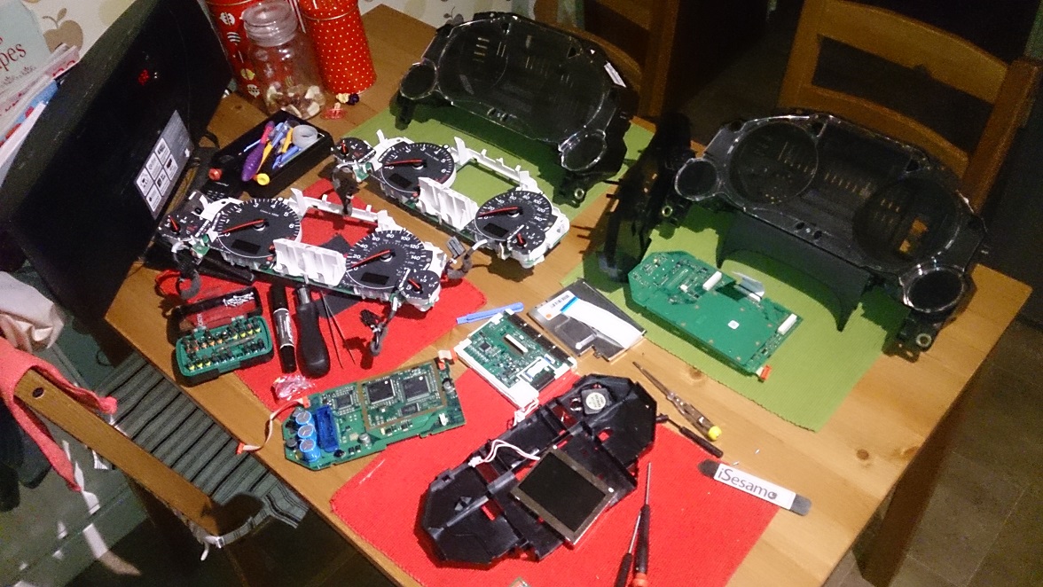

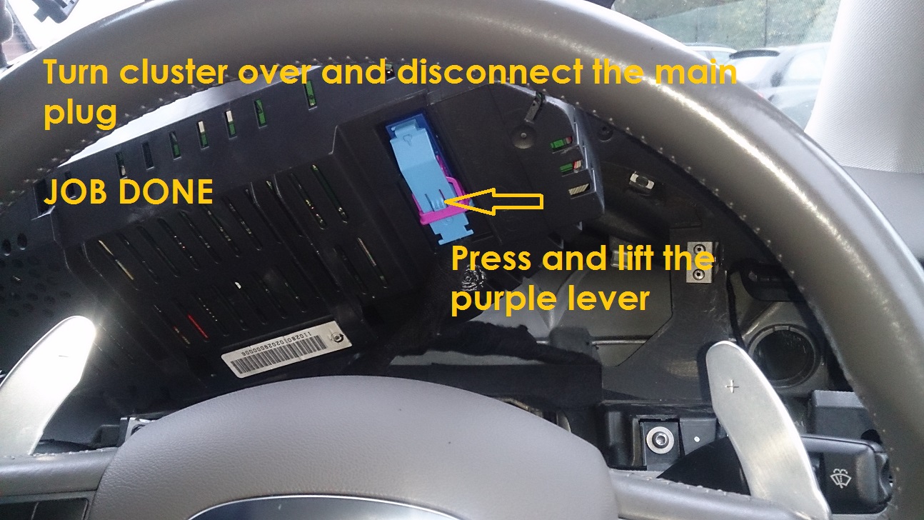

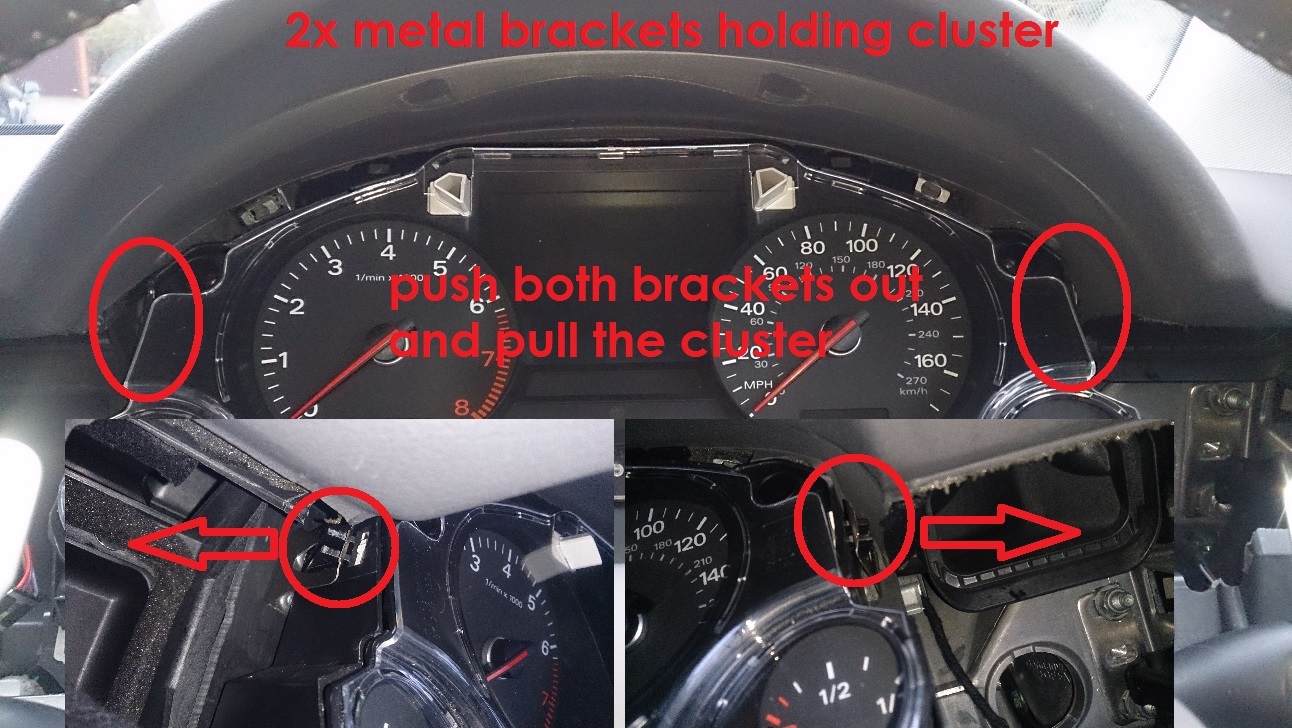

Tomorrow I will post a full guide of how to swap clusters for those guys who don't know how to do it or are afraid of it, don't, it is a simple swap and it takes around 10-15min. I managed to do two cars in under 25min.
So, after talking to my ex-Audi MTs they strongly recommend to get the correct cluster and don't bother with swapping the RPM's or SPEEDO discs from Diesel to Petrol or vice versa or KPH to MPH and vice versa.
From their experience on other Audi's the needles after removing and resitting will shake and give not accurate readings.
Plus, it's not tested if petrol cluster will work on diesel car after CP removal and coding.

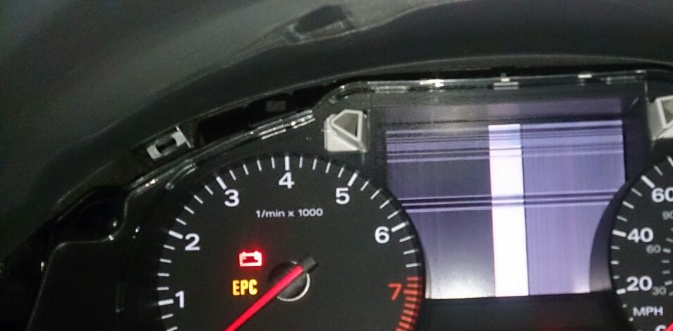

What I have tested is if you for example have a patrol car with small display and spare cluster with wide display from another petrol car, that you CAN'T avoid CP removal and mileage correction by swapping the LCDs.

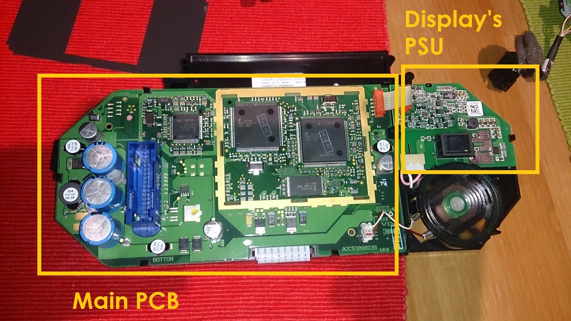

I've tried, swapping LCDs with it's individual power supply PCB, but no luck.
Display will be showing funny lines aven after playing with all the coding and adaptation options.

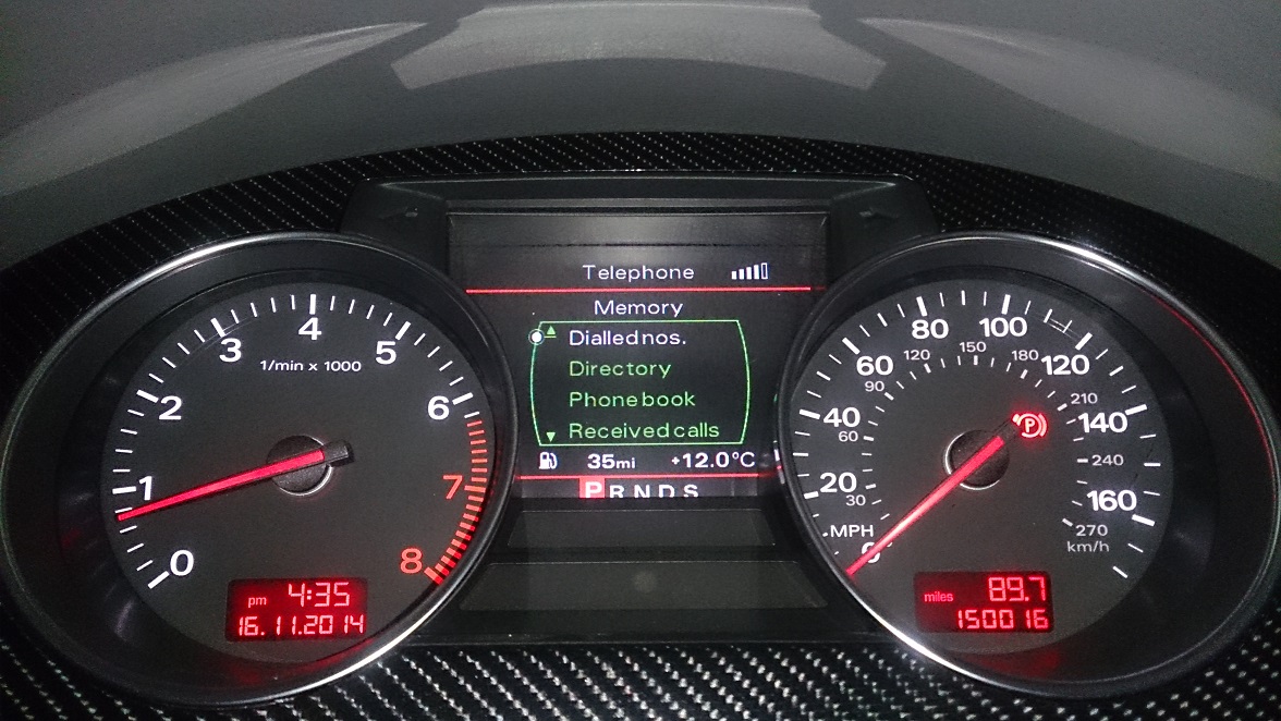

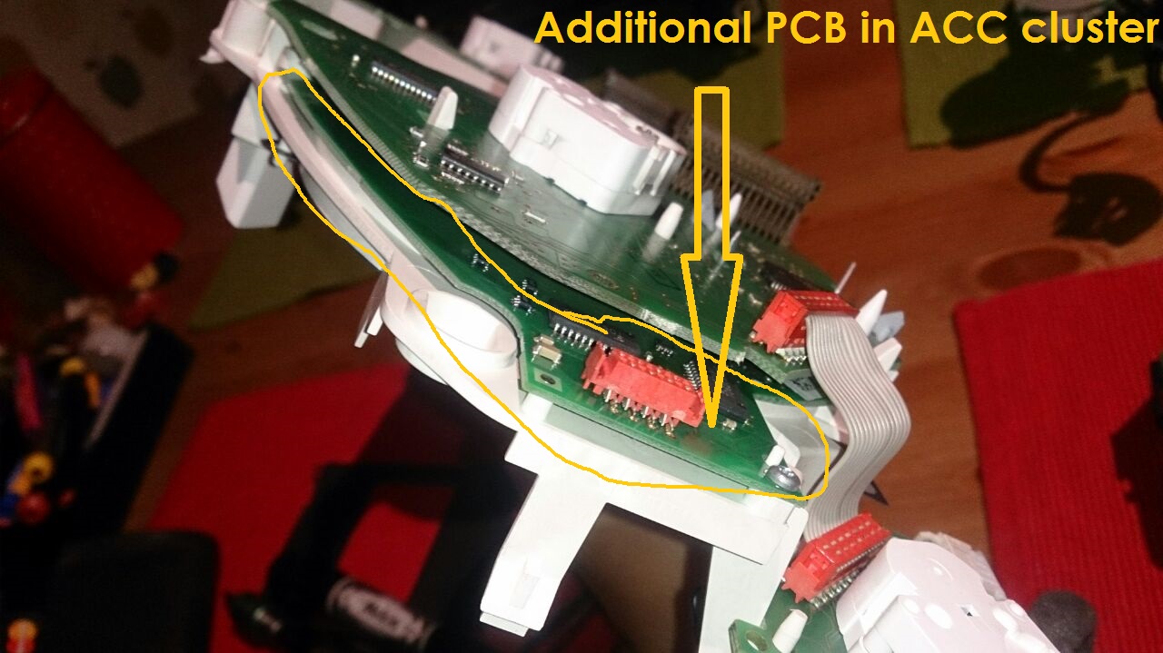

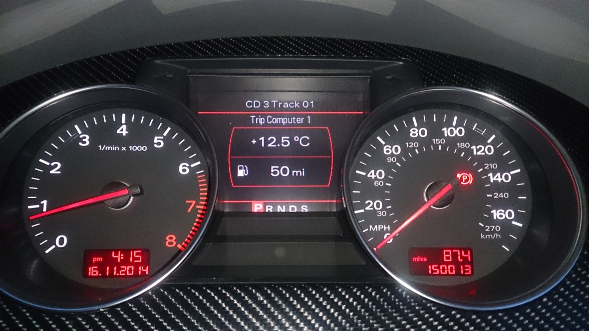

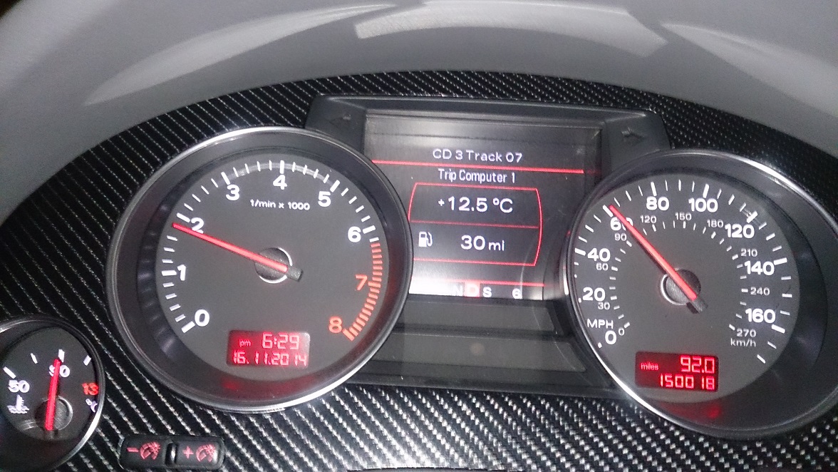

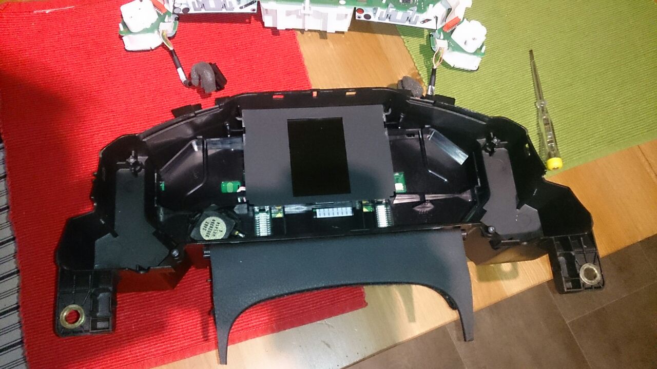

Below you see a petrol wide dis and petrol small dis clusters during the swap process.
Plus few extra photos if you are interested to know what's inside.
Differences.
So far I haven't found a single function being better on small dis than on a wide dis cluster , obviously
Benefits.

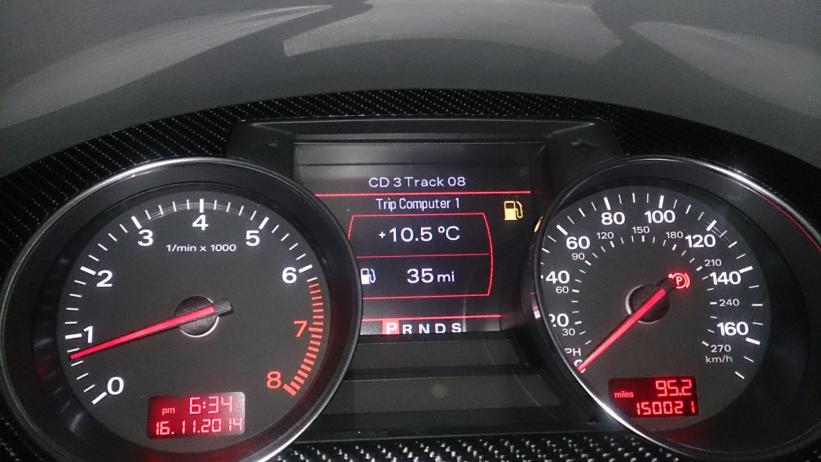

Main one is the look, absolutely amazing transformation and as I like to say more modern look.
Full track names (if you record CD text of course )
Full street and road names
When pressing MODE button on the steering wheel to get to the Telephone functions, MPGs and outside temp still displayed at the bottom of the screen, plus you will see signal bars at the top of the screen, not only on the main MMI screen
When fuel light or and screenwash lights comes on they wont take over the top part of your screen anymore, they will display on the sides.top corners so you can still benefit from full track names, temp etc.
Better Nav mode, in my opinion.
When displaying any of the Trip Computer functions it will actually says at the top Trip Computer 1 or 2

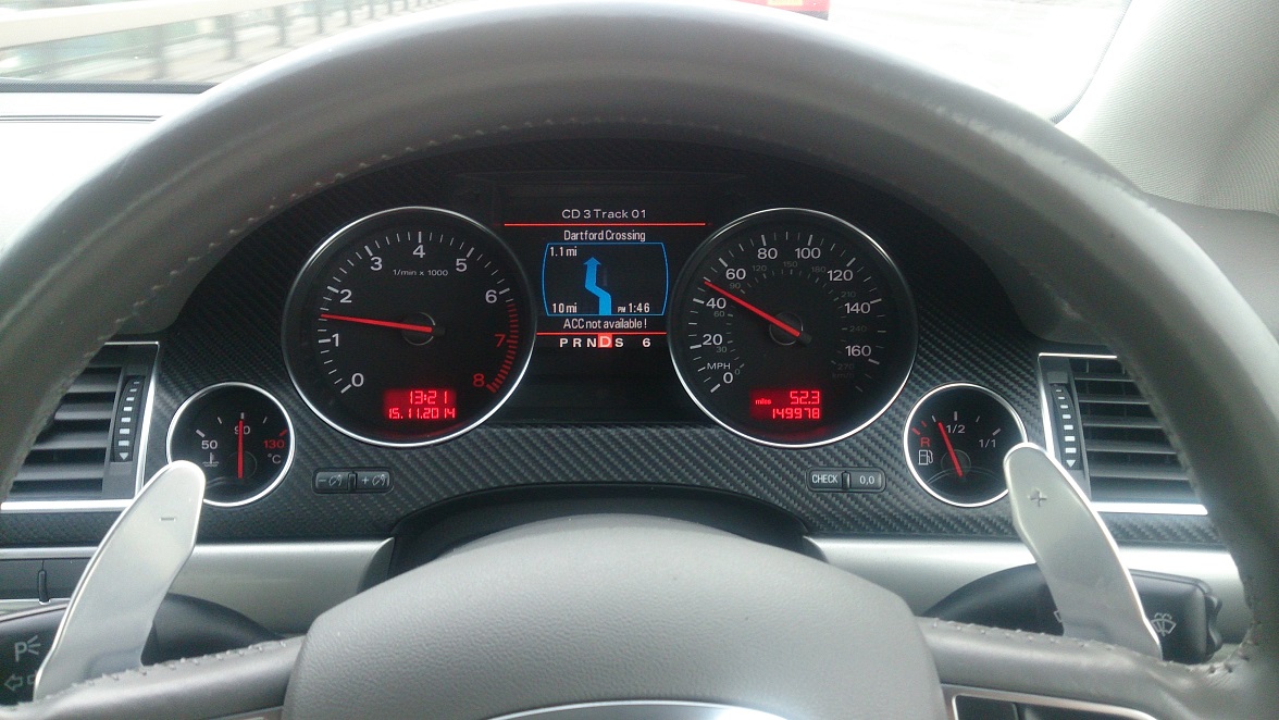

Also immediately after installing new ACC cluster and removing CP and coding it there will be a message on the bottom the display saying ''ACC not available''
This isn't a problem at all. You will need VCDS cable to deactivate this function/code out ACC function from the cluster.
To do that:
- switch ignition ON
- plug VCDS cable in
- go to [17] Instruments
- then Security Access
- click on the box where you need to type in Security Cody in order to get your code in a pop up window and type that in. Security Code is needed in order to enable Adaptation functions
- click Do It
- then go Adaptation and select ''ACC'' from the drop down menu
- change Test Value from 1 (ACC active) to 0 (ACC inactive) and press TEST and then SAVE and OK to save.
- Exit control module and VCDS and you are done. No more message ACC not available
BEFORE Coding-out ACC from the cluster
AFTER Coding-out ACC and test drive in CC mode where CC Green Symbol isn't present anymore

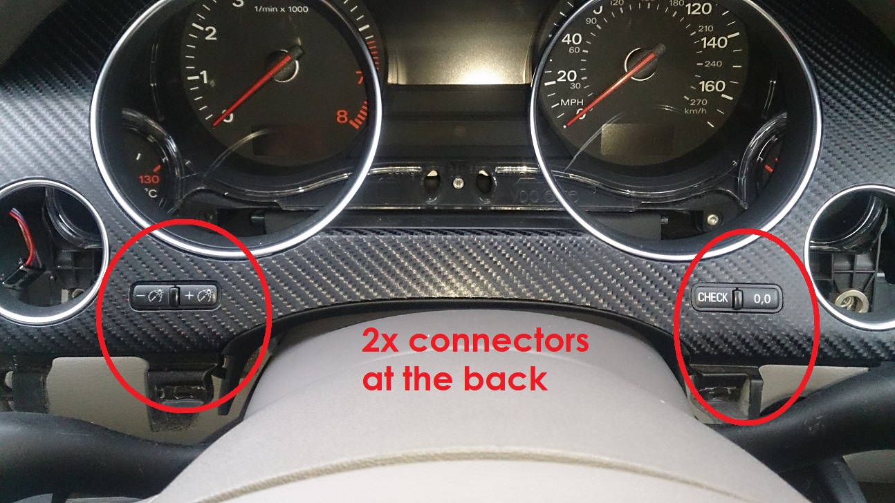

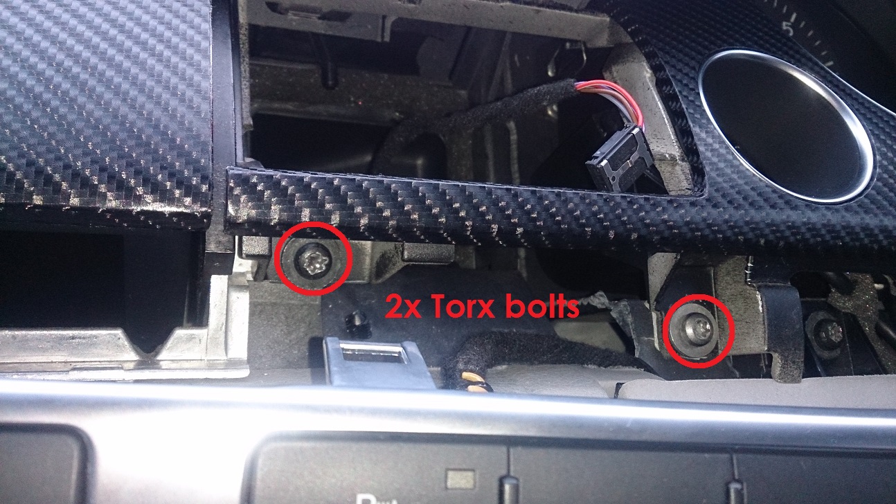

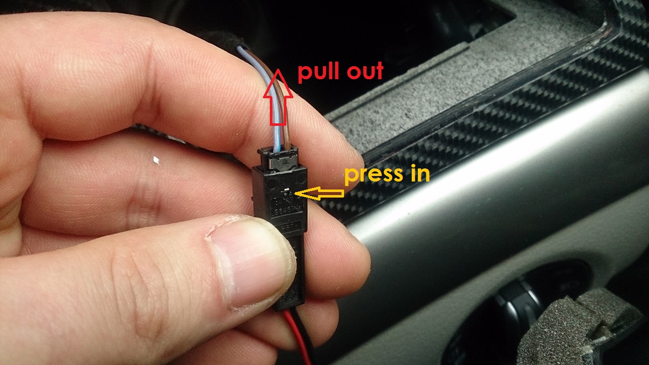

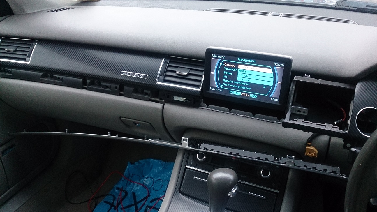

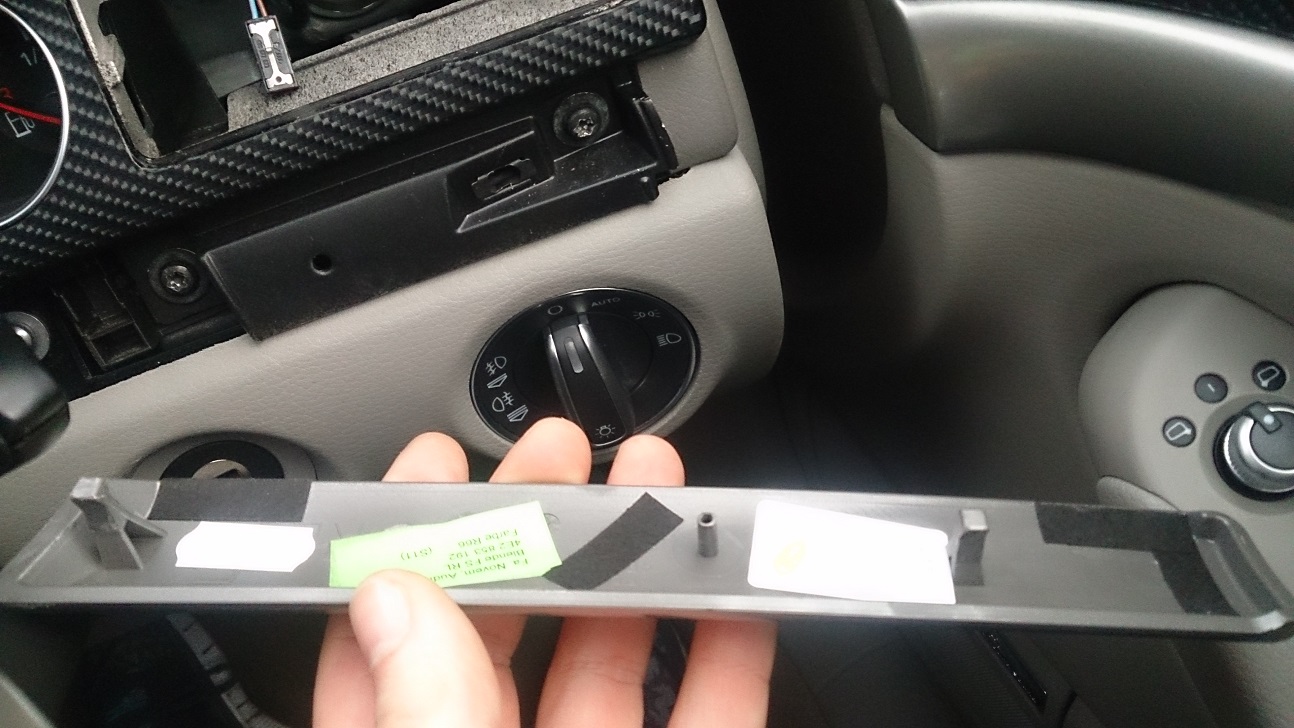

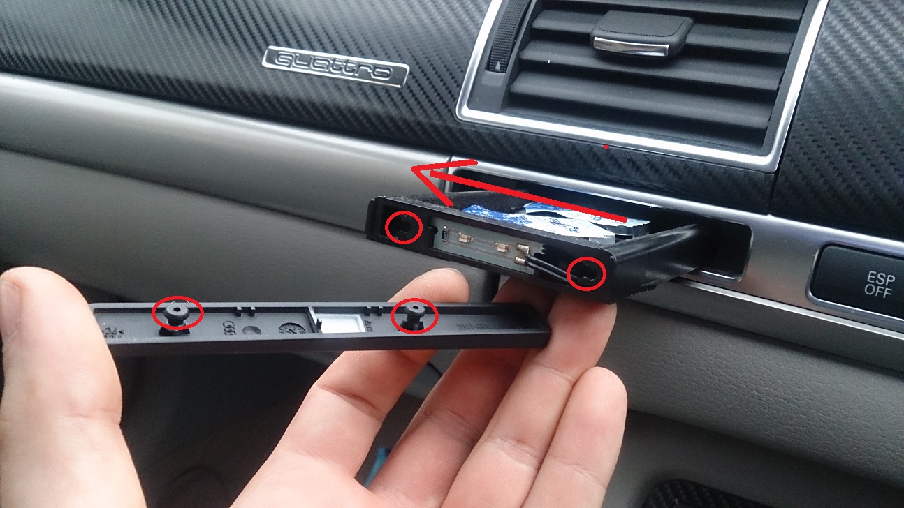

REMOVAL GUIDE
Disconnect air vent illumination
Remove decorative trim

Old 16th November 2014, 08:44 PM
d.f. d.f. is offline
Join Date: Aug 2014
Location: Bristol
Posts: 56
Stunning work Marcin.
You rule.
Old 16th November 2014, 09:15 PM
mannyo mannyo is offline
Location: Blandford, Dorset
Posts: 1,974
Got there in the end, looks like mine now.
Manny
Past
Old 16th November 2014, 09:43 PM
Good work Marcin
Did you get the MPH display in the middle of the DIS?
Old 16th November 2014, 09:45 PM
Cheers David, Mannyo and Del
Del, no or not yet. Will look tomorrow at all Adaptation channels and see if I can activated somehow or possibly this function appeared in MMI under Instrument Cluster in Trip Computer 1 and 2 selections of options to display after installing wide dis cluster.
Is it know for this option to be available on models with MMI 2G??
Old 16th November 2014, 09:49 PM
It works on mine but that was always widescreen from new, but if you need to compare settings you only need to ask
Old 16th November 2014, 10:01 PM
If I don't get anywhere tomorrow you can rest assured that I will ask
Also, I remember you can get in VCDS a tick menu where you can select and deselect certain options so I wonder if this is the case with MPHs.
Also, it could be a Green Menu option/tick ??
Will update everyone tomorrow after taking some photos for the cluster removal guide
