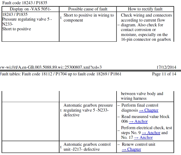

Hi all,
Sorry if this is a repetition, but I'm not sure if mine is slightly different or not.
Now and again all the gear selectors light up (this has just started to happen) and it feels like the gearbox has gone into 'limp' mode. If I switch the engine off and start again, then lights will go off but more than likely will come back on again. When I restart the car the gearbox goes back to normal.
So I scanned the car with a cheap code reader that I have and it gave me the following:
If I clear it, then it goes but will probably come back again. I have read about 'F125' switch etc, but I think this might be something different. Can anyone shed any light on this?

Weird. Your display says "18243 - 163 pressure control valve 5 (N233) short to plus P1835".
If you google that it leads to DSG gearbox errors, which you won't see on any S8. I'd get a "proper" VCDS scan and post that here.
